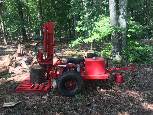

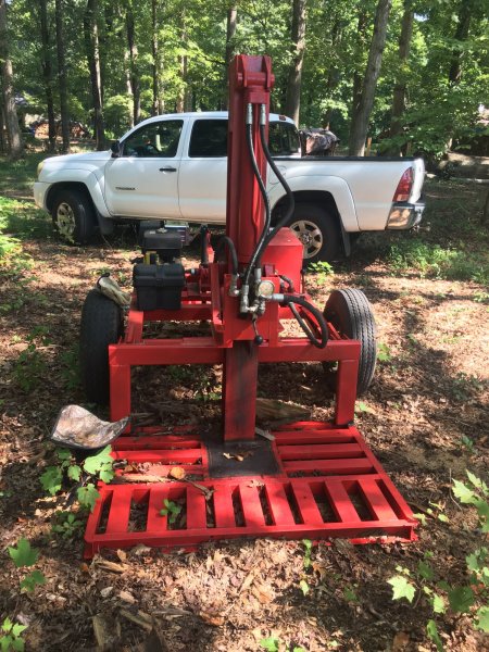

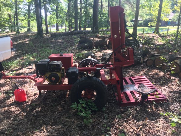

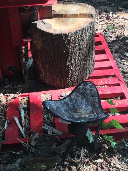

This is my custom built splitter that I’ve been using for about 4yrs. I have always split vertical because of big rounds and I’d rather sit than stand. Prior to the custom unit I was using a Speeco 17ton with a 5hp Briggs and that thing took too long to make a little bit of firewood. The custom splitter has a 13hp powertrain and about 13ton of splitting power. It increased my splitting production 2-3x, so I have been very pleased with it. I like the extra big foot the most, because it makes splitting big rounds easier. It’s easy to spin and slide around big chunks. The hydraulic horizontal to vertical is a must with the big foot. Had to put a new battery in her this morning before splitting. Taking a little lunch break before heading back out. I got an empty rack that needs to be filled and than I’ll have an excuse to make some more racks. post up your machines, I want to see what y’all are using!

No I move the splitter to wherever the rounds are. I have a Ford 2000, but it doesn’t have a loader. Rolling big rounds onto the foot ain’t to bad. I have learned to park it downhill from the wood piles so I get gravity’s help. My little swivel stool also helps with maneuvering wood onto the foot and it’s not too much for the back and knees. I’ve had plantar fasciitis in both feet, so I like being off my feet, especially since my job keeps me on them all day everyday.

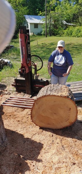

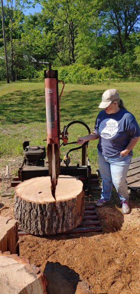

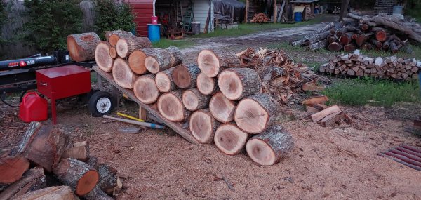

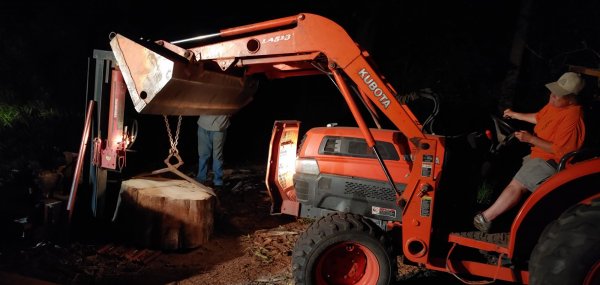

Very nice. I used to split everything vertical, but it finally got to our (my hunny helps) back and hips. Had to go horizontal mostly. We made ramps to roll/stack rounds on. For the big rounds, we have an older splitter set up vertical with a pipe frame to slide the rounds on. Use the tractor for the rounds that don't roll well. Ramps on the 30 ton splitter Pipe platform with the 25 ton splitter My hunny splitting 28"-30" oak Tractor handling 38" oak.
Some good ideas there and a nice job of building. I am curious though as this is the first time I've seen anyone sit on the side while splitting rather than directly behind. I remember one fellow trying to chastise me saying that for sure I would pay dearly when one of those hard spliter would suddenly fly out and could even break my leg. Wrong, and that is one reason I sit facing the spliter. Yes I've had a few fliers but the had nothing to hit going sideways. I like the little chair.
It seems like a natural position to me. My rounds are piled up at the foot, so it’s a matter of turn right to grab another. A pickaroon will make this step easier. Never had anything blow out sideways on me. It’s crossed my mind, but I don’t think this splitter has enough force to make exploding wood. It’s more about speed, so it’s not going shear through, or bust big knots. I’m a tree worker, so I’m bringing home fairly clean logs. I cut out big crotches and knots before the wood comes to my house.

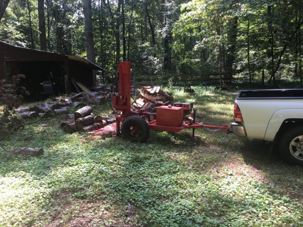

I toss the splits behind me or straight out and the area in front of the splitter stays clear for rolling more rounds down to the foot.
It’s held up well for the most part. It’s not a splitter where you can pick up the tongue and push to the next pile. With one offs you are doing your own r&d, so the weak spots show up. I broke the foot off and took it back to get a heavier base plate and more weld added. I’m on sloping terrain so the beam and foot are almost always slightly tilted back so the bigger rounds are putting a bunch of prying force on the foot.
