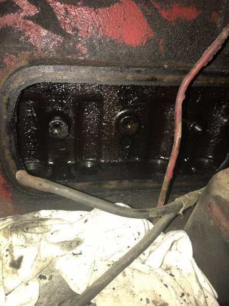

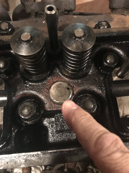

    Snapped a pic this morning quick. You can see the two regular valves then the little cap my finger is pointing to has the starting valve under it which drops compression as well as opens the combustion chamber to were the spark plug is. It's operated off of a cam shaft that links to the handle up at the seat. The handle also opens butterfly's in the intake manifold to allow carb mixture to flow into the cylinder as well as un-grounding the magneto. IMG_1613.JPG
