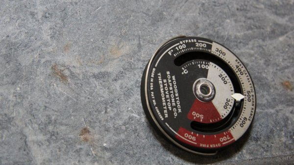

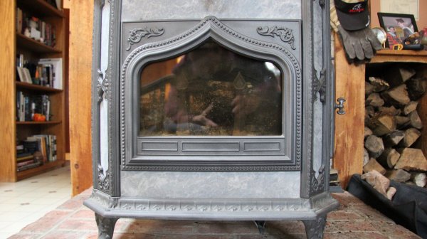

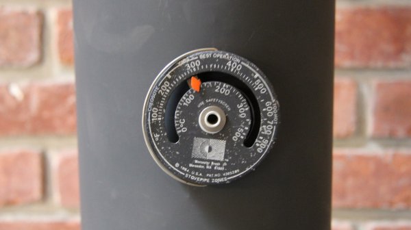

    Good wood, good draft (a cold day) AND make sure the Cat is actually ignited (temp went up some and flue temp went down)... after that it's all about experimentation. I love getting the box looking like it's just smouldering... (no flames) and the STT is up there over 500'F.
