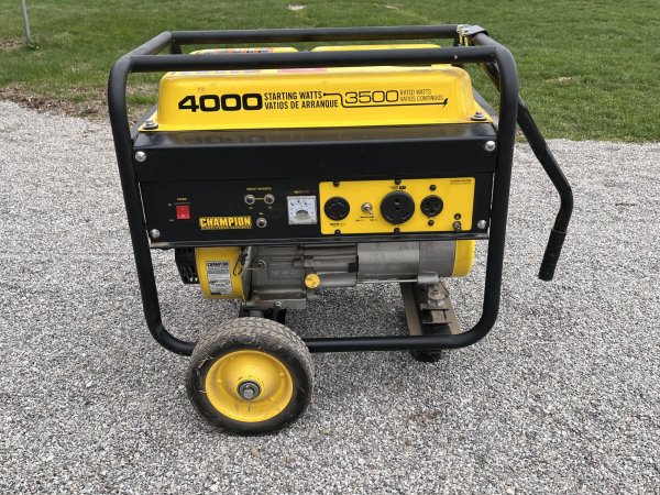

    I'll get some pictures later of the generator. It was an el cheapo Champion open frame RV generator from TSC when I bought it 10+ years ago. You get what you pay for sometimes.
    You are spot on why the microwave wasn't happy after doing some investigation. I'm not sure why, but the electrician put the majority of the 120V breakers on the left side of the panel and most of the 240v breakers are on the right. I've always been told that they should be balanced as best as possible.
    My microwave is 1700 watts input (14.166 amps) and 1000 watts output.

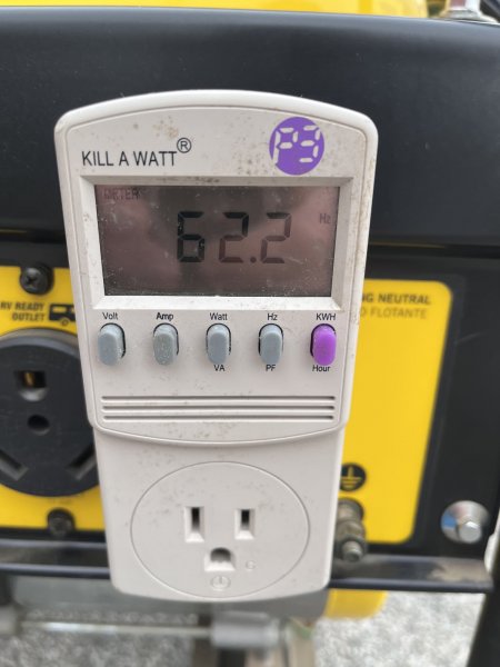

    What generator not to buy if you want clean power. The frequency was jumping from 61ishHz all the way up to 64Hz. Plugged an old school fluorescent work light into it, it didn't change. Plugged the Kill A Watt meter into a socket in my house, it's a pretty consistent 60Hz.

    that’s a very good clone of a very good engine. If it was surging, not holding a steady hertz, it is because the carburetor was gunked up.
    Any generator with a gasoline carburetor will start surging as the carb plugs up. It’s pretty common since generators often sit unused for long periods.

    Exactly what I was thinking (among possibilities) when I posted this earlier
