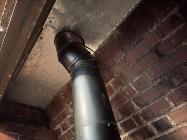

    Aaaaand we’re done. Block off plate was more dicking around than I anticipated but what isn’t? I’m sure as hell not a tin knocker but it’ll do. 2 layers of rockwool above. I reworked the connection to the liner with one more piece of pipe for less angle so hopefully now I can run a brush through without disconnecting anything. If so I’ll just leave it top vented. My rods are rather stiff, do they make a more bendable cleaning rod?

    Sooteater.
    Tons of cheaper knockoffs on the net.
