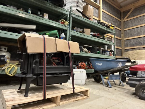

    Tomorrow is the day. Off to the polls first thing and then headed to pick up the Jotul. Going to have to stick into the barn for now though. Have a lift reserved for the 23 to get the liner in.

    she’s home. Can’t get a lift until the 23 so I’m the garage for now.

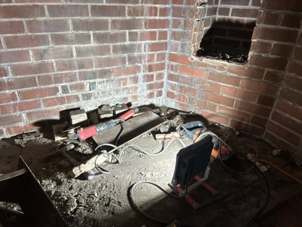

    Got the damper and frame removed yesterday. Haven’t done that in about 12 years, totally forgot how much fun it is! There was about 18” of ash/creosote/bricks and other debris on the smoke shelf so cleaned that out too. At least there is a lot of room in this one, I was able to stand straight up into the chimney to clean smoke shelf. Going to work on getting water stained brick cleaned up a bit more and have to make some sort of lid for the ash clean out. Anyone with tips to get the bricks cleaned up? I was using vinegar and water, seems to work ok but slowly and you have to flush it a lot so there is tons of water making a mess.
    Went down fireplace store and bought a bunch of parts I think I’ll need. I’m sure I’ll be making another trip on the day of install but it’s not a good job if you only have to run for parts once!
    Have some help lined up this weekend. Getting closer.

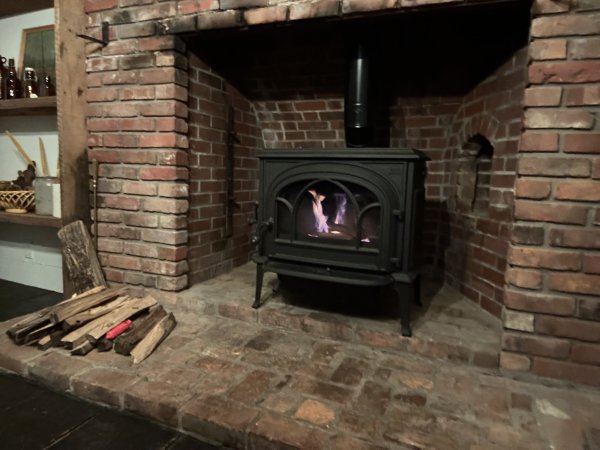

    Is that a warming oven, or? Very Cool fireplace holy cow!
    Eckie, Eric VW, theburtman and 2 others like this.

    And we have liftoff.

    I believe that is what it is. The frame was totally rusted from years of leaking so I took the door out for now. I’m pretty sure they still make them so I’ll be looking to replace that.

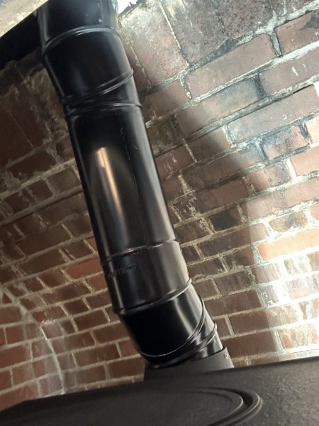

    Install went pretty smoothly. Having a 18x13 flue makes it quite easy to drop a liner down. Much easier than the 7x7 at my old house. Wasn’t able to use the tee as it was too long so for now it’s top vented with two adjustable 90’s. I have to find a shorter tee with a crimped end that attaches to the stove. Can still take it apart for cleaning the way it is but will be a bit more difficult.
    Just above the top 90 is appliance connector going into the flex liner. Tomorrow I’ll stuff the chimney with safe n sound rock wool and fashion up a block off plate.

    Wow, nicely done! Do you have a fan on the back of stove to push the heat into the room? Or relying on the brick to radiate it?

    I have nothing yet. Early stages of seeing how this goes. The stove sits proud of the opening about 8 inches and it’s a very radiant stove from the little I’ve burned it so far. Hoping I don’t need a fan but we’ll see. Jotul also makes a blower for this stove but it’s :makeitrain"
