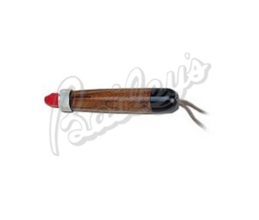

    For years I used this method cutting firewood and also just eyeballed it. I used to be pretty good at eyeballing but not so much any more. So, these I use. They come in a box or you can order them singly. I like the red best. On the right side is a crayon holder. I like it and it saves a lot of broken crayons.
    Contrary to those who have problems with wet wood, although they won't make a bright line like when dry, they will make enough mark for me to still see it. One thing I noticed through the years is that it is best to not use it as one would a pencil. That is, sort of straight up and down. I mostly sort of lay it and draw toward me. So rather than using the point, I'm more using the side of it.

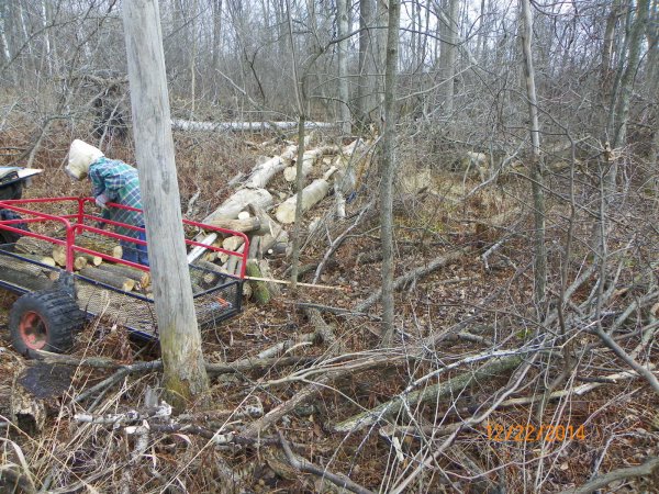

    In the picture, if you look close you can see our marking stick. It is laying just behind and to the right of the trailer. It is a 4' stick (there are times I'll cut a 4' and then carry or drag it out) and spray painted red at both ends (easier to find, especially in snow) and also a red mark at 16" and 32". Guess I should have taken a picture of it but saw no need at the time.

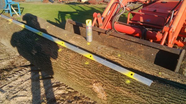

    I use a piece of aluminum stair nosing and a spray bomb to mark my wood. I have 3 different ones for different lengths. I usually cut the big stuff off my forks or manure bucket. Works good for me.
