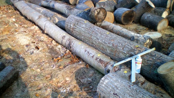

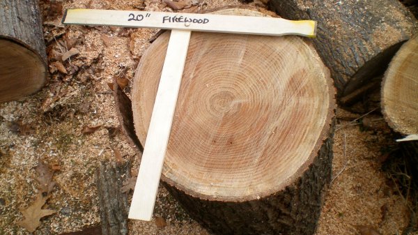

    This has worked perty good for me riks The rounds will be within an inch of 20" . Close enough. What I like about it is I can walk along a pile of logs and mark all of them as I go, because I'm not using a tape that started from just one log (which never seems to be laid exactly the same on one end)... I can just go from each mark to the next. Saves time. I've tried lumber crayons, but I've gotten used to the ease of a quick spot from a spray paint can.

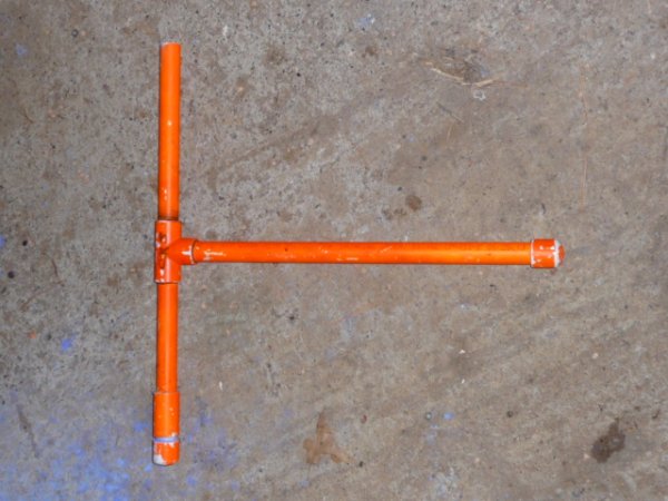

    Tap 'N Cut
    Tee made from 1/2 pvc pipe. Small hole at 16 in. (for me) from one end. Cap on base of tee not glued, remove to fill with carpenter's chalk. Lots of bright colors available (I use blue, as you can see). Walk down the log, place end on previous mark and tap, placing a spot of chalk. Mine has two holes for right or left hand marking, the split collar (made from 3/4 pipe) is rotated to select hole. The end that appears to be open (top) is actually plugged internally.

    Oh and I use the Stinny stick method with cans of old spray paint. When I'm cutting to haul out log-lengths I just go 6 marks of 17" for 102" and make the cut.

    I used to use the bar length method myself until my buddy started helping me cut again. Now we need something way more accurate since his "eye" is just a tad off!
    That's where the stick and old (regular) spray paint comes in. I purposely spray the end of the stick so I get a pretty sharp mark on the log. Right now I've got a bunch of old cans of paint left over from projects but our county has a recycle/reuse place where I can go and load up on more. If the cans still have paint but no propellant left I can usually just pressurize them with the air compressor and get a bunch more log spots out of it.
