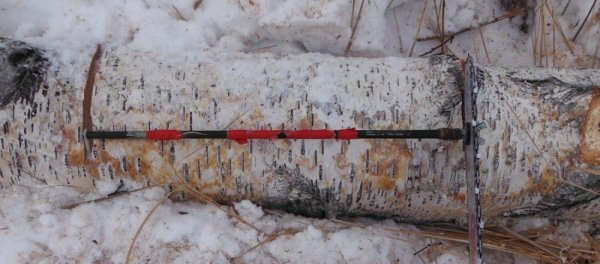

  2. bogydave
    Mostly just walk the log & mark it. Then remove & cut the log to skid-able lengths.
    Sometimes I cut rounds if the size & conditions work out.
    My method of getting wood by felling & skidding logs to the trailer
    a bit different than most.
    Short vid:

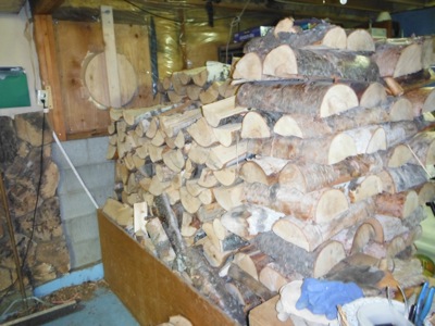

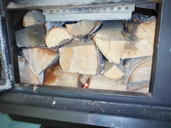

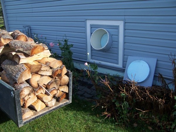

  5. bogydave
    If I could cut to within 1/2 inch of 17" by eye
    I wouldn't use it.
    but I am within 1/2 " using it.

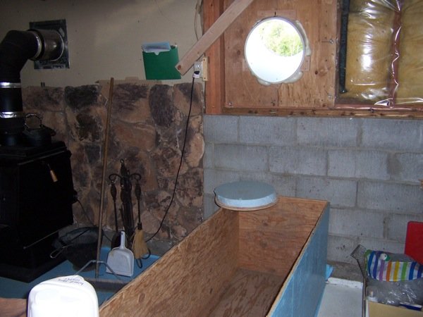

    Anal, yea that's me, me & my stove are pretty finicky & like 17" firewood.
    Before the length measuring bar jig: 15 to 20"
    Now 17" ( they all fit) ;)
    What mess in the house ? Wood chute into the basement wood box near the stove. :)
    Oliver1655, Chvymn99, Horkn and 5 others like this.

  8. bogydave
    I used an 8' stick with 17" marks for a while.
    Over time it ended up to short to measure more than one
    at a time. :confused:
    This method has worked well for me
    for 3 + years , for my style of cutting.
    Now it's second nature to put the measuring rod on the bar
    & measure 17". I can carry a spare now.

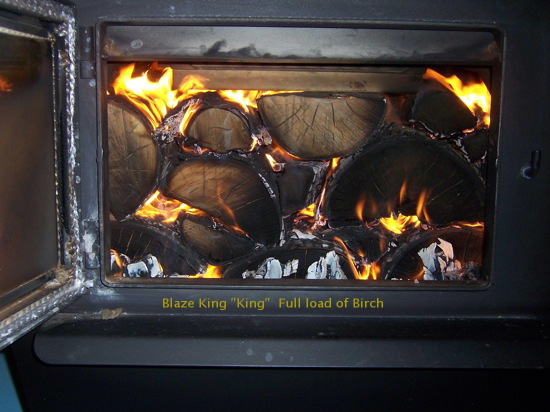

  17. bogydave
    Wood loaded N/S (North south) :
    Loaded the other way would be E/W
    HoneyFuzz likes this.

  20. MasterMech
    9,648
    26,041
    Greenville County SC
    The safest way to use these is to attach it via magnet or a wing nut, then mark the cuts you want to make on the log. Once the cuts are marked with the saw, you detach the measuring stick and make your cuts normally.
