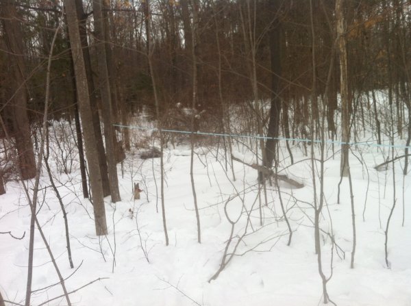

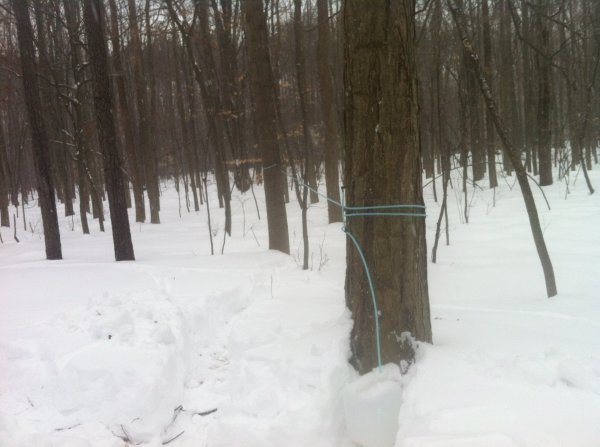

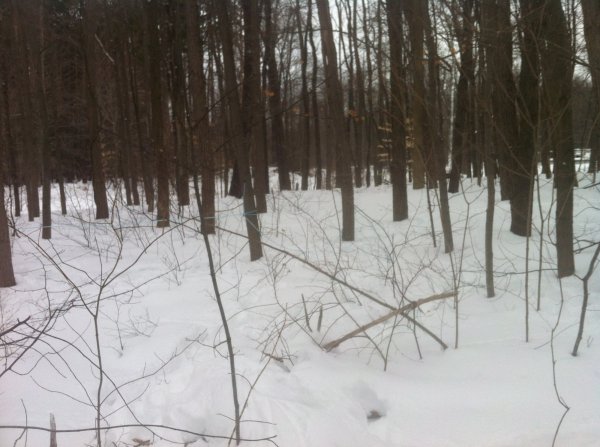

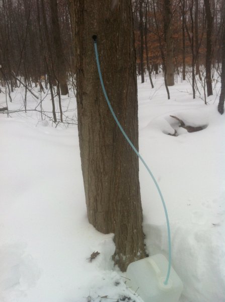

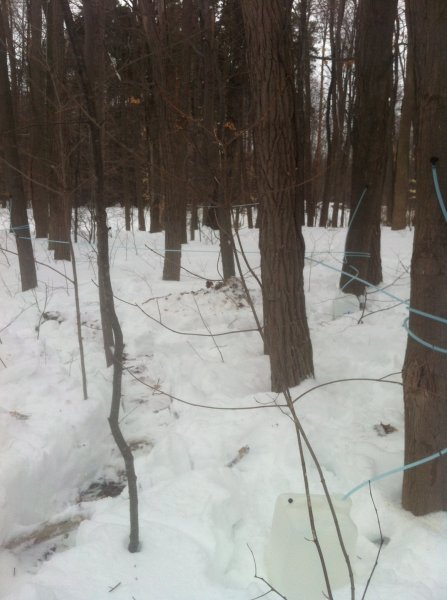

    Lunchtime progress update! 7 more taps so far so I'm a little behind schedule. I didn't have this section tapped last year, but its by far my highest concentration of sugar maples. I'm basically running the lines N-S, about 4-5 trees per section, with the collection point close to the edge of the woods, by the road.

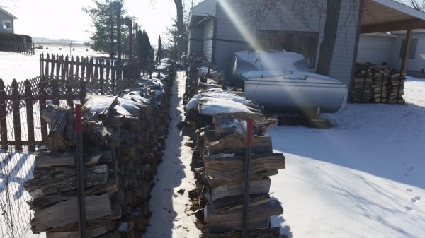

    Wishlist has a dairy tank and many folks here in MI do the same. I know of one party who uses both the SS tanks and also a couple plastic tanks. The sap will keep longer in the SS than in the plastic. No, I don't know why. Perhaps it has something to do with light; sort of like beer usually is bottled in dark glass. I do know you can keep sap a week with no problems so long as the weather cooperates. When it stops freezing nights and gets into the 50's daytime, well, the run is about done anyway.

    Most are 18" and up, but there's some in the new section as small as 8". They're close enough together in there where I can link them in N-S rows, so I'm hitting some smaller ones just for convenience sake.

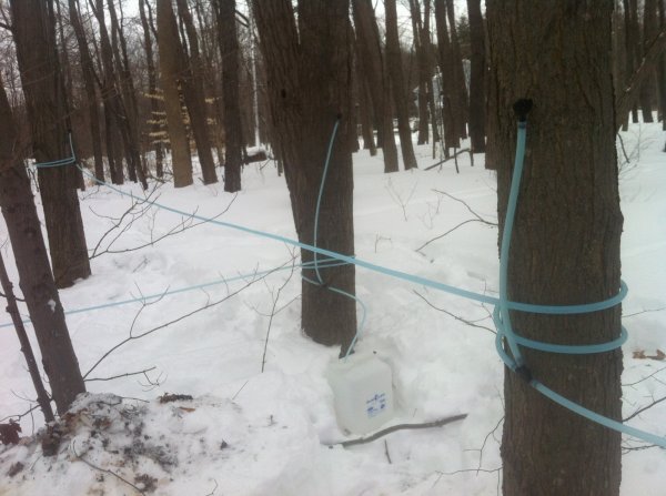

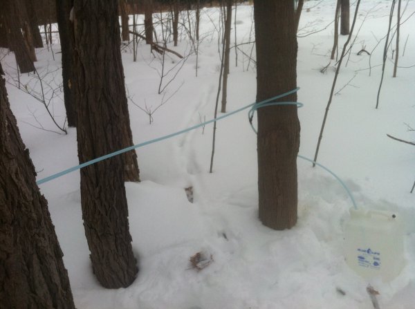

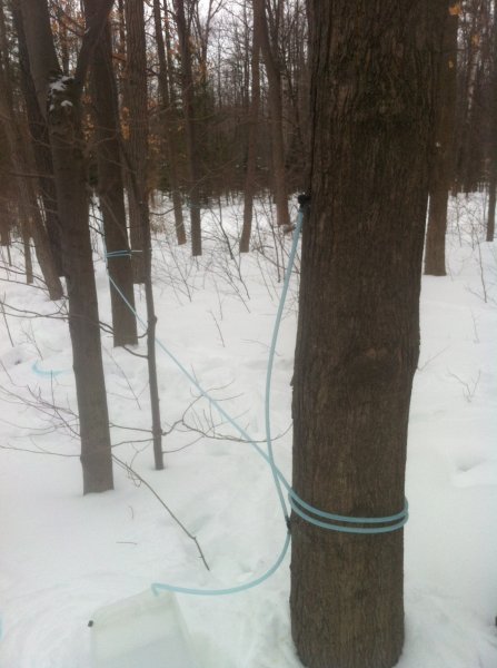

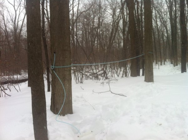

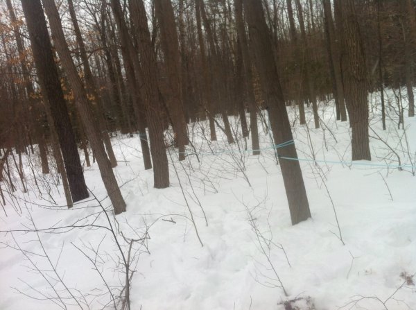

    Few more pics - 13 taps total now. Warming up for a minute then were gonna work on a couple of the easier sections.

    Dennis, I'm up to 4 dairy tanks. I love those things, easy to clean, drain completely , and do indeed keep the sap cool.

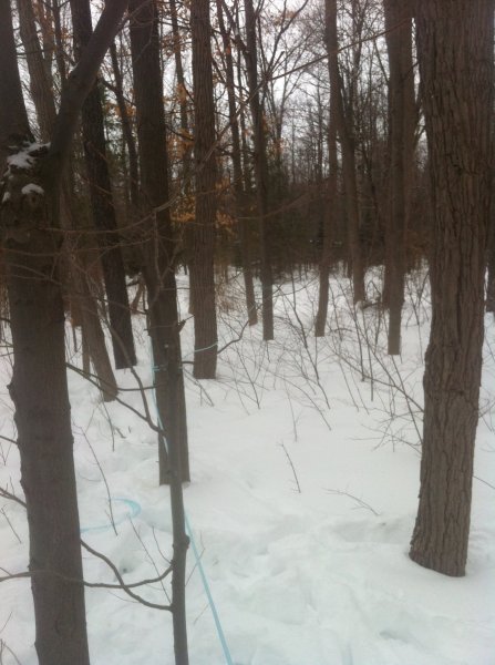

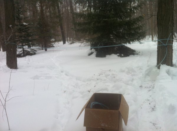

    20 taps in so far - not as many as i planned for this weekend but its double what I had last year. My girlfriend and her daughter were a great help today.
    Here's the rest of the pics - enjoy!

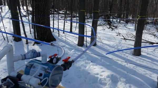

  19. wishlist
    wishlist Guest
    Looks good Shawn, one thing I noticed is you tapped really high with a long drop into the container. When running tubing especially on flat ground I tap high at my farthest tree but only enough to get a decent slope , 2% is good and have the last tree's tap just above the collection container. Think of a maple tree like a straw full of water, If I put a hole half way up the straw it will drain down to the hole and no more. Put a hole lower in the straw and get more water !

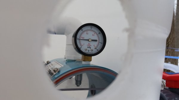

    With vacuum you get 150% more sap at 15" hg and 5-7% more for every inch of vacuum over 15" . Huge gains in volumes and no harm to the trees. Some guys with smaller setups use Shurflo pumps like whats used on rv's for water supply. Inxepensive , and can be run on 120 volt or 12 volt.
    Cleaning tubing is really pointless. Some still do it but using bleach is a no, no! The salt residue will attract those tree rats and you'll be fixing a bunch of leaks . Leave the tubing open and just let it drain for a bit , couple days. Any left over sap will turn to vinegar. No harm done. :)
