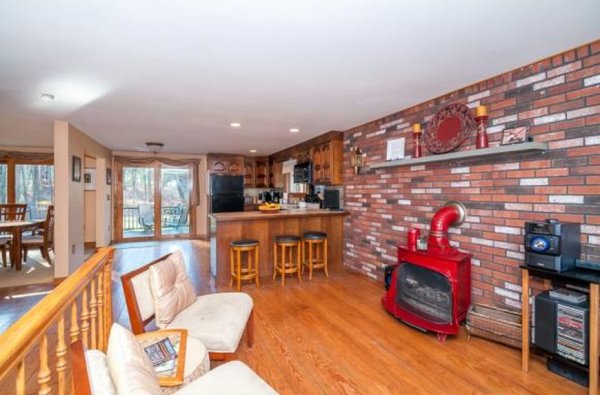

    In the words of the former owner of my home "Meh, who needs a hearth"
