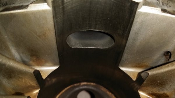

    I would replace the piston Dex. But that's just me. ;)
    No transfer at all eh?
  3. DexterDay
    DexterDay Administrator
    12,411
    31,637
    Northeast Oh
    I meant to put piston in that list. I went back and read it and seen I didn't have it on there (had a few drinks last night ;))
    As for the transfer?
    No.. You can't feel anything on the jug. I'm still gonna hit it with 180 and 320. But it's smooth as a baby's bottom. The jug is good. Just needs a Piston/Ring.
    I thought about just running it as is, and then putting a 79 cc kit on when it finally chit the bed. But I'd rather fix it now and save the jug. If I decide to get a 79 cc jug for it, I will have this one to sell, trade, or keep as a spare. :)

  12. DexterDay
    12,411
    31,637
    Northeast Oh
    Jug cleaned up. :)
    Only took about a minute ;)
