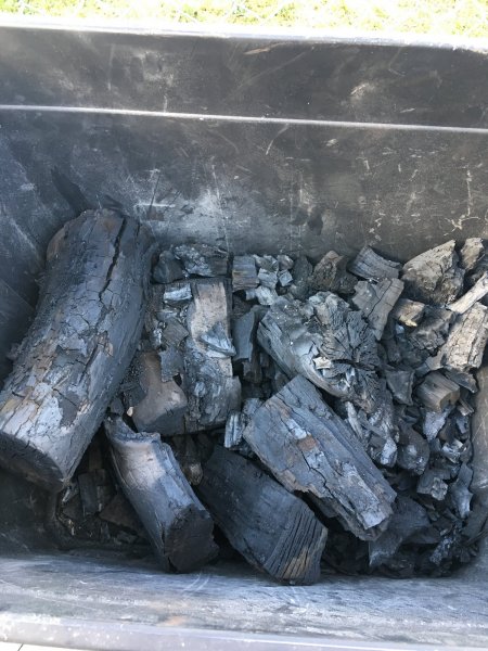

  13. FatBoy85
    FatBoy85
    Feb 25, 2017
    6,592
    25,094
    Washington State
    The lady and I got to cleaning up and burning pallets last night, I had prepped for some charcoal. Fresh charcoal from apple. This one really came out great. 35F57413-2FEE-4A08-873B-AA5AB8F25D1D.jpeg
