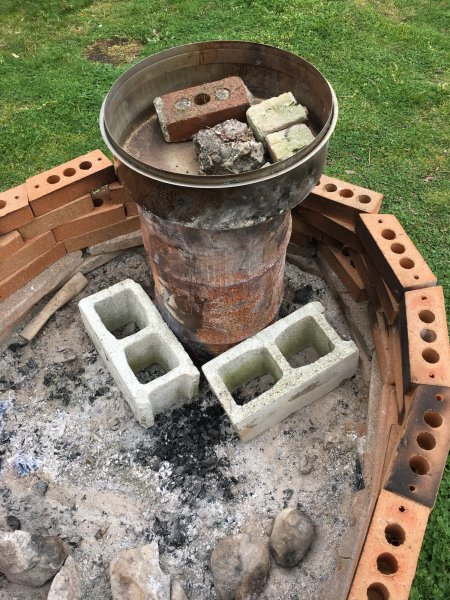

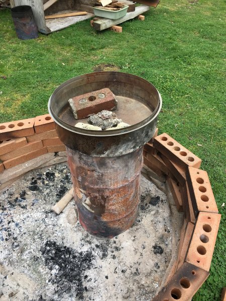

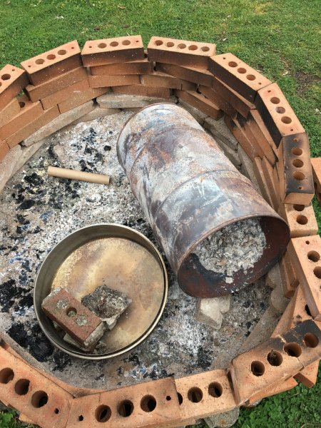

    Not realizing how much the rocks underneath were affecting its balance. So it became top heavy and ...*kerrrplew* and likely some form of rocket fire *SHHRRRRKKKK* with the sound of brick Krk! krk! While I was inside sawing wood. 2FB2790D-444B-4BCD-A187-6D242DD24D42.jpeg
    Should have done something like this prior.. and shoveled some coals around the barrel. 3D0FA2C4-CB95-4042-9531-BEF82275530D.jpeg

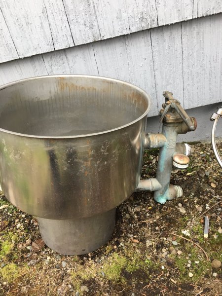

    The top you’re seeing is part of a pool filter. The container for that is smaller and all stainless steel. Really nice and sturdy but have a heavy piece of brass fitting on the side to remove before that can be used to make charcoal too. Might even be more useful as the whole thing is flush with parts, gonna post and edit here. Kinda cool huh, just the brass is super heavy needing to remove but even that itself is cool too! image.jpg

    I will probably make it again later. I realized some errors were involved and mostly that was because of no airflow from below. I’m impressed you remember that. I used the bricks and put spaces but they didn’t get hot enough from below so if theres a way to fix that, I’m listening!
    I will get plenty of that sorta thing fixed up this summer. I remember that if I can find some good steel grill square pieces that aren’t so wide(not much more than 6inches, although room for me to cut them to size) and go for it. I just love to bbq, old standbys and something new. Never hurts to keep trying.

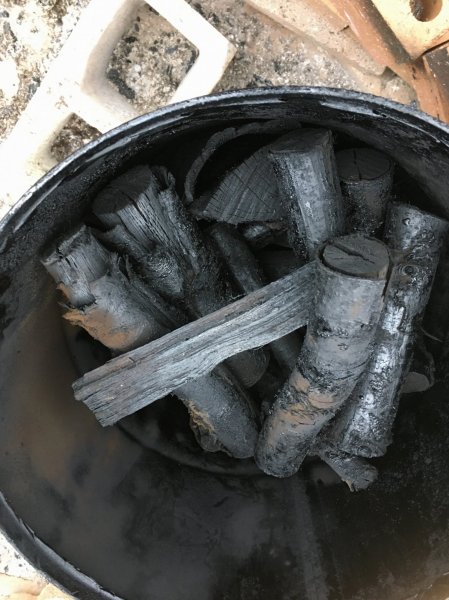

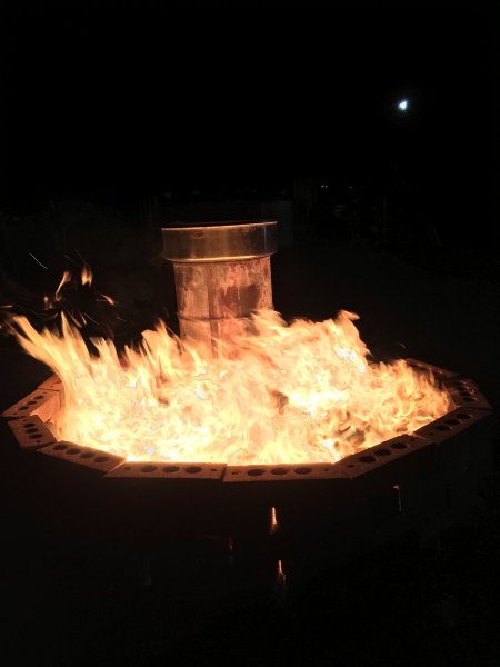

    Success!!! Last night made some with a quick burning fire and morning cooled off things pretty quickly. Can’t wait to get this batch in a container and use it!

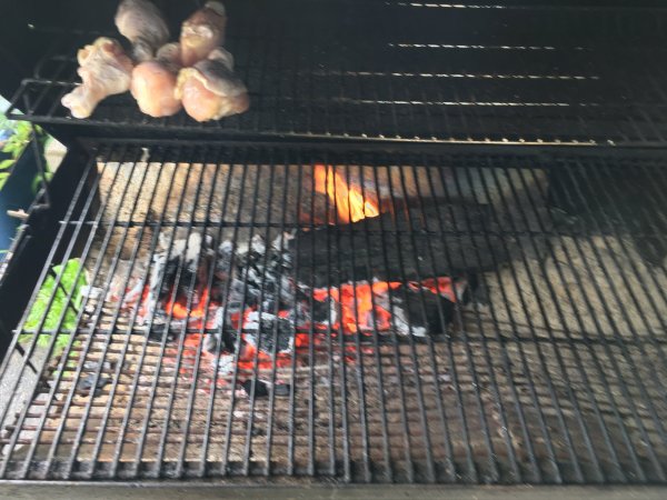

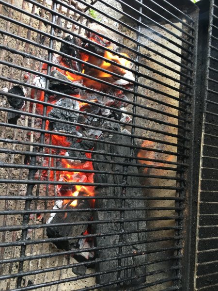

    Thought I should show you this but I picked maybe a couple lbs of charcoal out. It is phenomenal. There’s no doubt in my mind that this will be my tried and true way of bbq. Great lasting heat, flavor is definitely likely to be there. Small pieces go a long way. Started it in my chimney with that eco light from kingsford, i use paper often in the summer, much easier to light when the draft isn’t there and coals are dried up.

    All I did was tried to find a small grease barrel. Don’t burn up your dad’s vintage 76 or conoco oil one!!!! I found mine at a cement mixing place. Go figure but they likely do maintenance on their own trucks there too. Anyways burn it out first on a hot fire, paint and oil will be involved but I do not recommend this for your safety.
    Now with the legal part taken in stride, place oak splits in cool barrel and then make sure it’s in or near your fire being so heavy. I have a large pit so its easy for me to get it in. Put barrel in the fire open side up and find a steel lid that is not air tight, but sealable. I got mine off a pool filter lid. Put rocks on the lid and then line edge of the outside of the barrel with more wood and coals and give it a long burn.
    Make sure that the barrel wont tip over, had this happen to me and woke up to nothing but a bunch of ash and cracked bricks. Any hardwood should work but I’d stick with hickory, pecan, oak, and likely any fruit woods too.
    One thing I’m noticing is the fly ash is more so on real wood opposed to briquettes. Small price to pay for some quality charcoal. Hopefully we can get others to post how they do theirs!
