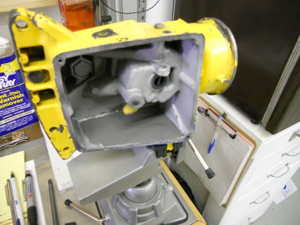

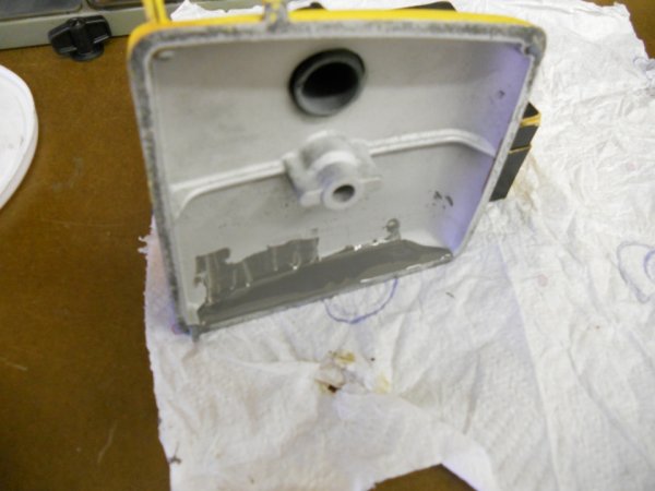

    Don't overlook JB Weld, I had to patch the gear box in mine as it had been setting with some moisture in it and was corroded through. On another uncommon saw I had to build up the clutch cover with JB and it worked out very well.

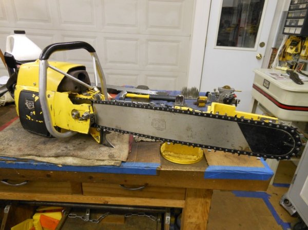

    Just to nudge you in the right direction, here is mine with an Auto-Mac bar (oils through the bar directly to the nose sprocket) and the Auto-Mac self sharpening chain. The built in chain grinder stone touches the clutch drum to spin it while it is touching up the chain.

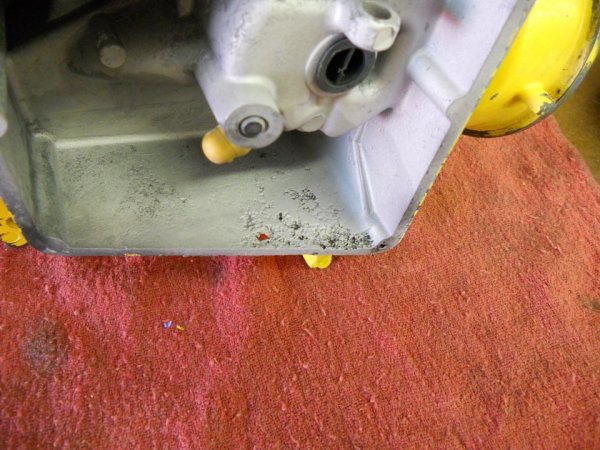

    The gear box before
    Patched, this has been holding up well for several years.

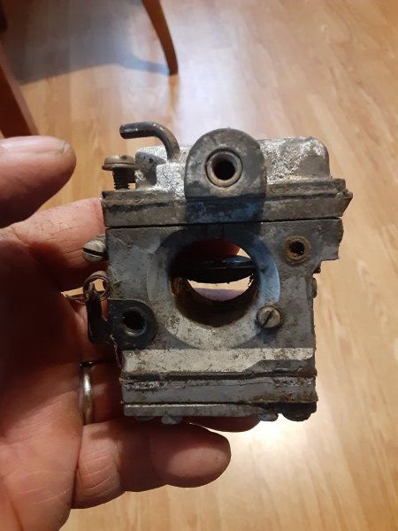

    I've got an extra BP-1 carb, but I think it's pretty rough. I need a BP top cover, I'd trade you if you have an extra.

    Is it rebuildable?

    Have you opened it up yet? I have one that looks almost identical to that one, it's pretty much unusable. The insides are roached....
