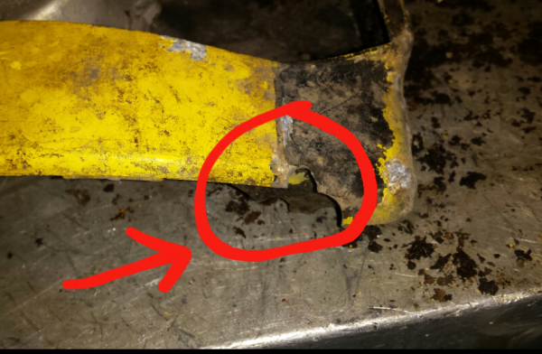

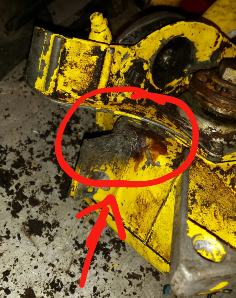

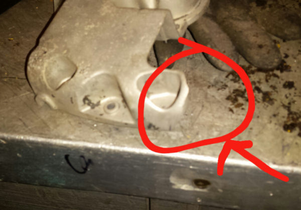

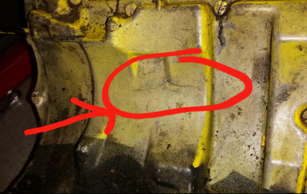

    Mag Craft, here's pics of the parts I need repaired....
    Small chip out of side cover needs welded and sanded flush...
    Fine crack in backside of fuel tank needs welded. It leaks fluid. Non cosmetic.
    Chunk missing from back corner of bottom piston chamber/case. Merely for cosmetics. I'll make the replacement piece, it will just need welded.
    Worst part of all is the bottom handle mount on the gear case. The entire chunk is missing and will basically have to be built back up by layers of weld. There is also a crack associated with this missing piece and gear case oil leaks out of it. We'll probably have to open up the crack with a die grinder to clean it good so we can weld it. You can see brown epoxy from an old repair
    This saw hasn't ran in at least 40 years, maybe longer. I bought it out of California, where I believe it was found in a junkpile. So I don't expect miracles, let me know if you think repair is possible. I will media blast all parts that need repaired prior to sending them out.
