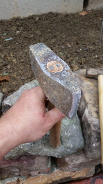

    ....because building these natural stone flowerbed walls is very hard on these stone hammers!

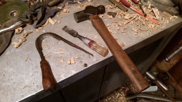

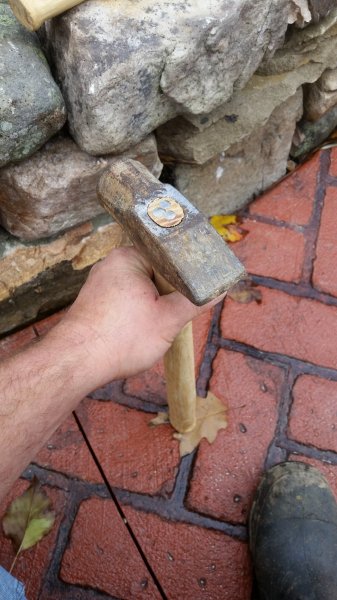

    I've got a whole bunch of antique stone hammers, some dating to the mid/late 1700s, and I bought them to USE them. After breaking the handles on three of them, and with the miserable rainy weekend we had, it was time to make some new ones out of some nice straight grained locust heartwood I put back almost two years ago for that very task..

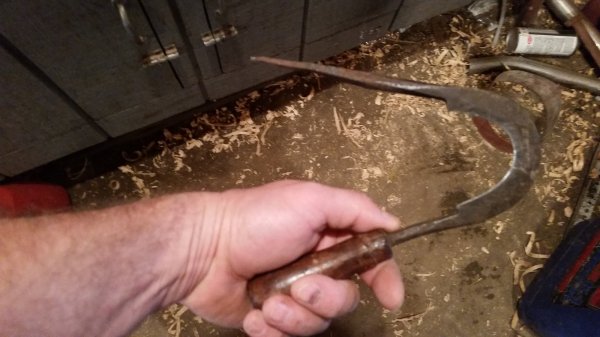

    Didn't get many "during" photos, I was busy all evening making these handles. I used an 18th century curved draw knife (which works incredible for the task) and a sharp chisel, along with an old handforged ball peen hammer (that my great-grandfather made when he was a blacksmith at the PRR in the early 1920's) to do the task, these handles should be good to go for a while to come!
  2. Scotty Overkill
    9,272
    60,637

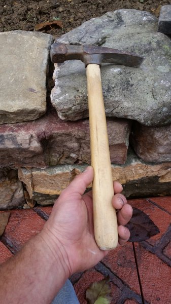

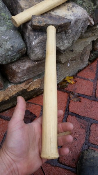

    The one handle is repurposed. It was the hickory handle I put on the one stone hammer several years back, it snapped right at the head. I whittled it down, and although it shortened it up a bit, it's actually more usable being shorter...
    I have a ton of miles on this hammer, it was the first stone hammer I ever aquired.....I've probably worn at least 3/4" off of the point.......
    thistle, Rope, Boomstick and 13 others like this.
  3. Scotty Overkill
    9,272
    60,637

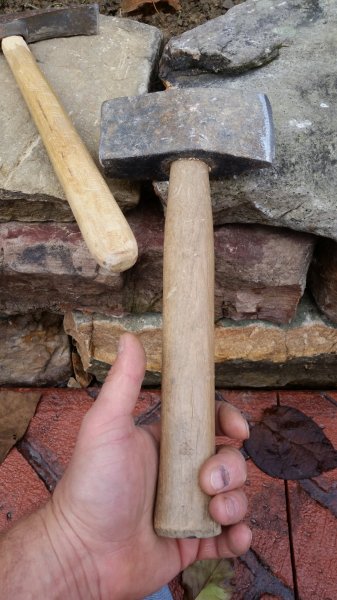

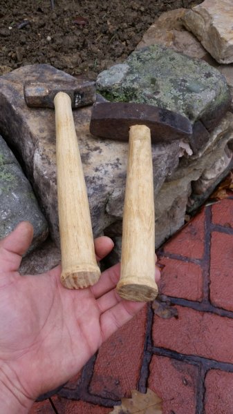

    This vintage Craftsman facing hammer is good for dressing the edges. I first made the handle for this one last week, snapped it off at the head, whittled it back down and reused it.....
    thistle, Rope, Boomstick and 14 others like this.

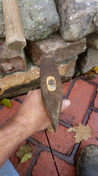

  4. Scotty Overkill
    9,272
    60,637

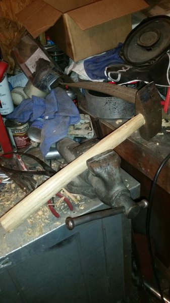

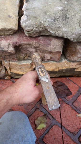

    Then there's this hammer, which I found at a tree job we did a few years back. It was laying in the dirt inside of an old stone foundation at the property we were cutting at. This is the first handle it's had since who knows when....
  5. Scotty Overkill
    9,272
    60,637

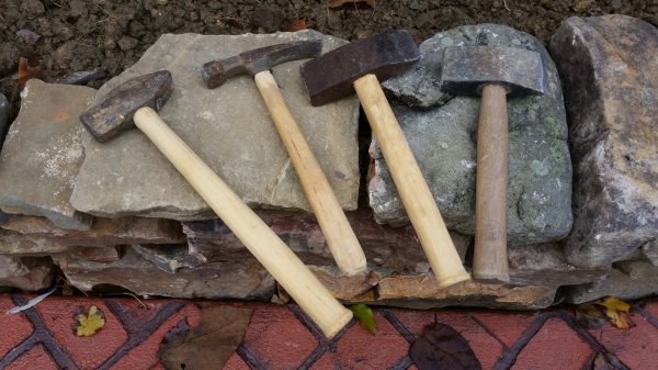

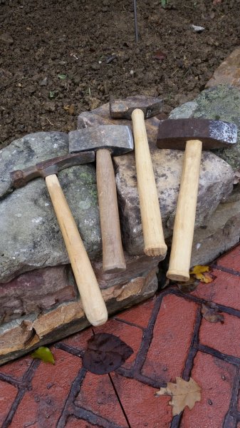

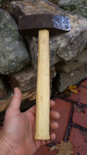

    Lastly, an old blacksmith hammer that I use for stone. The handle had been cracked for years, finally made her a new one....
    FatBoy85, thistle, Rope and 16 others like this.
