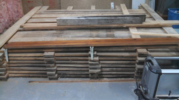

    For all this Oak I acquired back in '08.
    All this.......

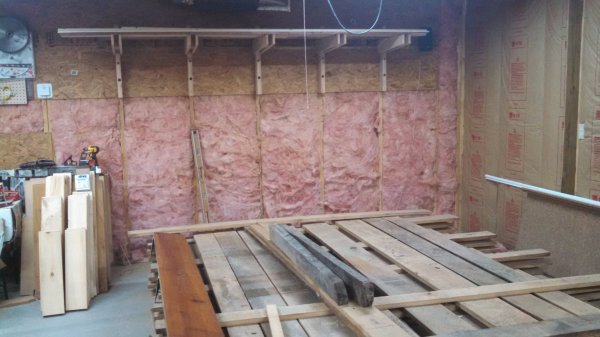

    Will eventually end up on this wall...........
    Over 100 sq ft of floor space will finally be opened up. I counted 140 boards.

    Looking good man, I have a good sturdy wall rack but it won't hold that much.
    Do it right, that's a lot of weight, make sure the wall can take it:)

    That's a 2X6 partition wall, spiked into the floor, and the trusses. I'm more concerned about the 2X4s pulling off the wall. :hair::D
    I don't plan to overload the racks, and whatever's left over will be stickered on the floor in front of the racks. Some will be milled for at least one gun cabinet for my brother.

    I am not nitpicking or saying you are doing anything wrong, I don't know the particulars, just saying do your homework.
    I think gussets would be a very good idea, even though it will limit the number of supports top to bottom

    The brackets are 3/4" ply with a 2X4 sandwiched between, glued and screwed. The brackets are then slid over the 2X4 on the wall and screwed to that with 8 more 2" screws. I can take a closeup shot. They're made the same as several others have done on the "Tube".
    I originally planned to drill holes in the 2X4s and use 3/4" EMT pipe as the "arms". That plan failed. :headbang:
    Heck, if anything, I may have weakened the 2X with all the screws. :rofl: :lol:

    I went with Industrial Steel supports in my pole barn, 10' long rack, did all the math, holy crap that was not easy for me:hair:

    you do not have to rely on the cantilever rack, you can add front supports for the weight, Yes it is a little inconvenient put it does not seem you move it regularly.

    Yep, could very easily attach some uprights to help hold the weight if needed.
    Jon, I've gone back and forth whether or not to add more brackets, or just cut some shorter stickers and stack in front of that wall. Doing that would save a bunch of work.
