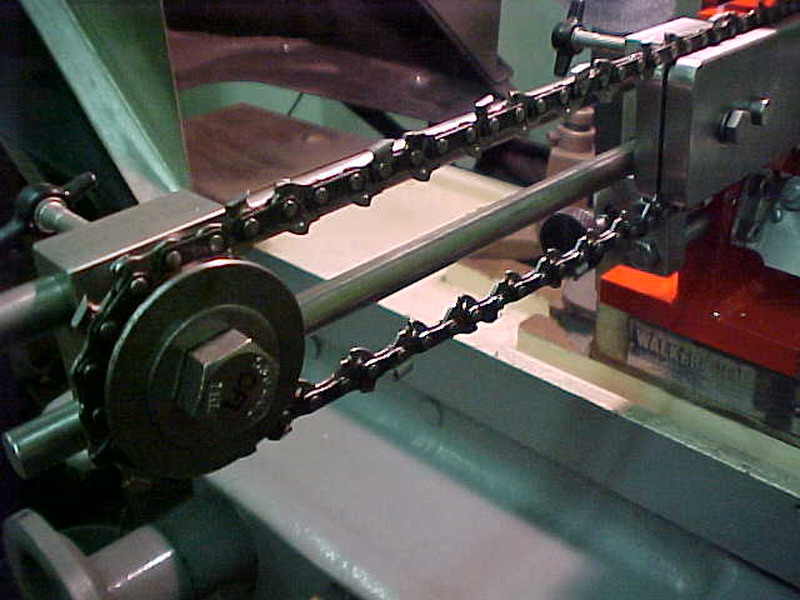

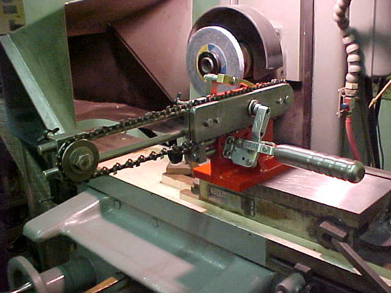

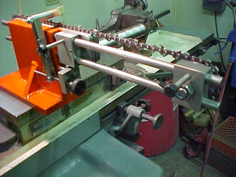

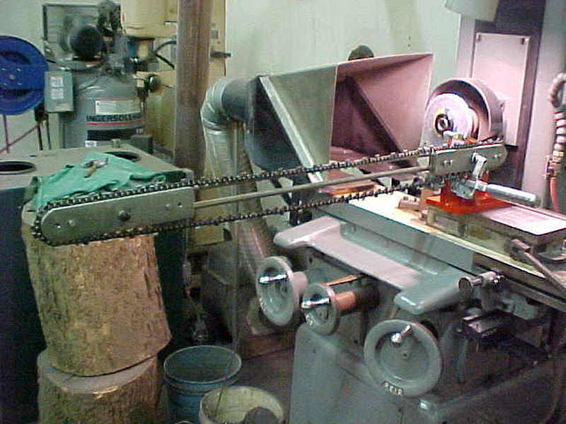

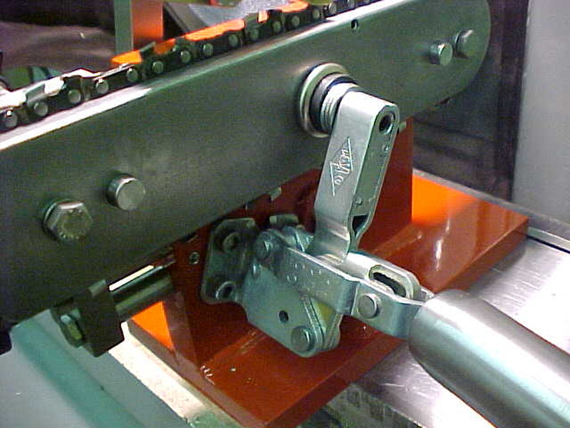

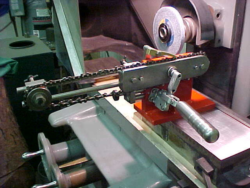

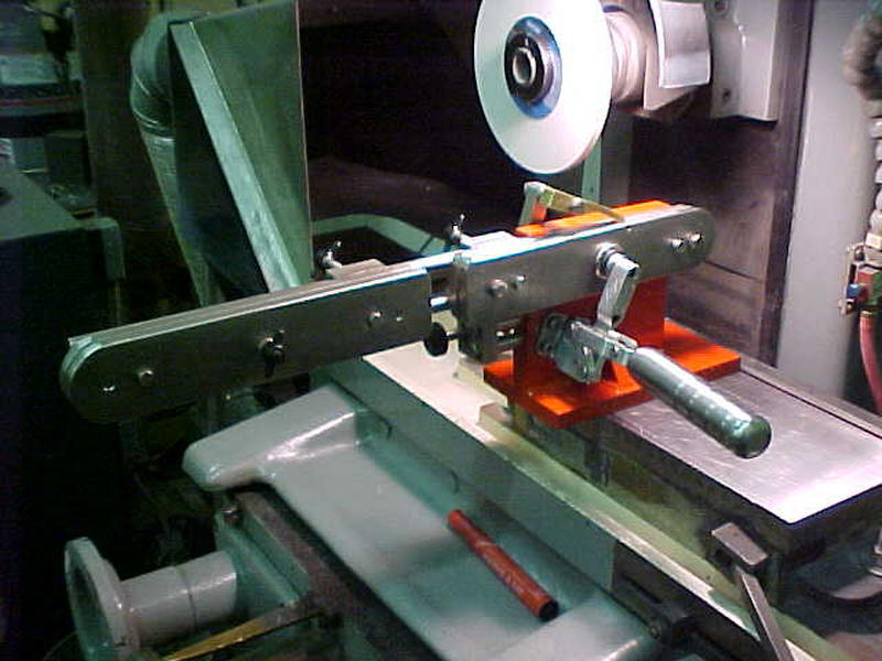

    Single wing nut screw locks it down in a hurry for easy, quick adjustment for various sizes.
    Tore it all down and painted the mild steel so it won't rust. reassembled and looks even better.
    I can use this set up for 10 - 22 inches
    This will do 16 - 32 inches.
    This will do 20 - 48 inches.

    Put the first chain on the 028 and was actually surprised that I noticed a difference. Much smoother than before. I did not resharpen the chain as that was all ready done on the initial test, just evened and rounded the rakers.
    Some did not clean up so it can only get better if I use this all the time. I set this chain for .030 depth cut. Some fines in there but I'm pretty confident it will change when I get a complete, even grind.
    So far so good as this chain was probably about 1/2 to 2/3's gone.
    Heading out now to try a Picco chain which will be a different wheel dress.

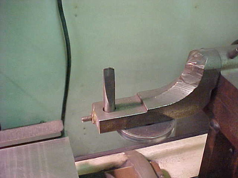

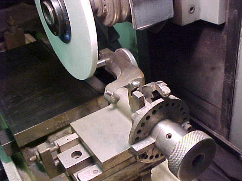

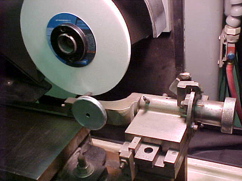

    First thing I do is set my radius dresser to .350 above centerline. I use a chisel diamond and have set this dresser up after I got the machine. This system makes it easy to get what you want without having to use gauge blocks.
    Diamond set so we are ready to proceed.

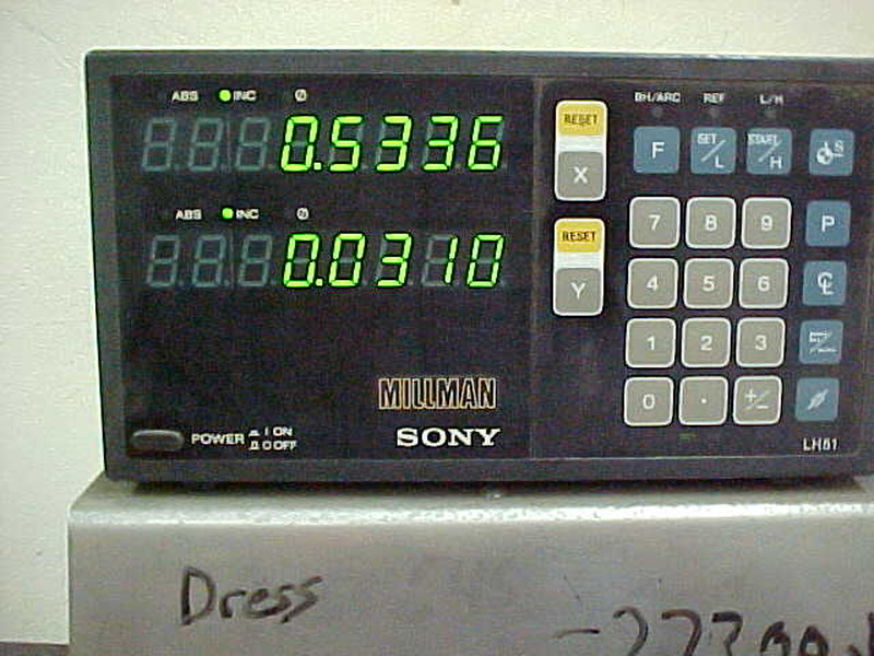

    This will be easy as I want the total width of the radius to be .250. I just get a .250 wide wheel so no side dressing is needed. First I touch off on the front side.
    Then I zero out the Y axis.(infeed)

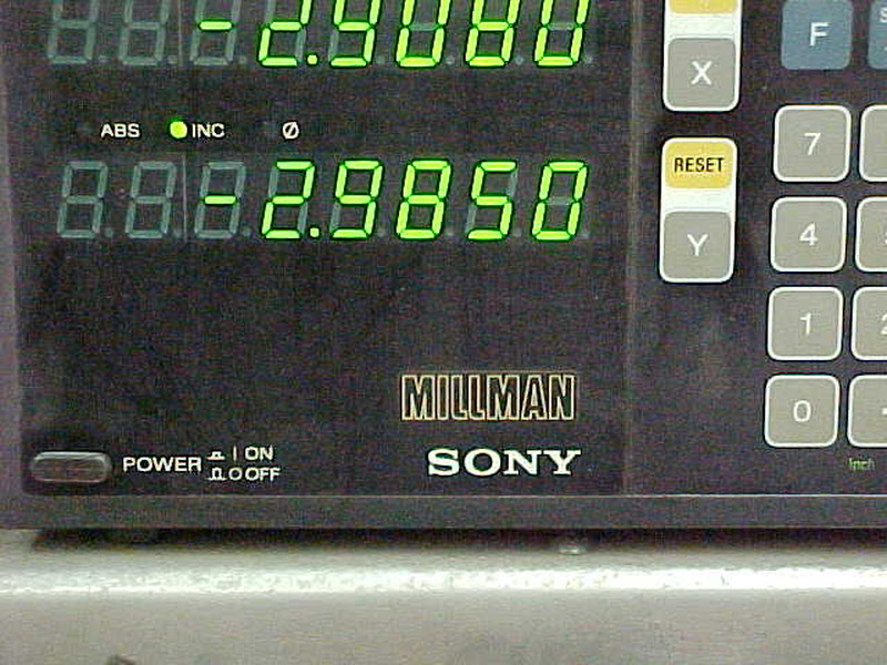

    Then I swing the dresser arm 180 degrees and touch off on the backside of the wheel.

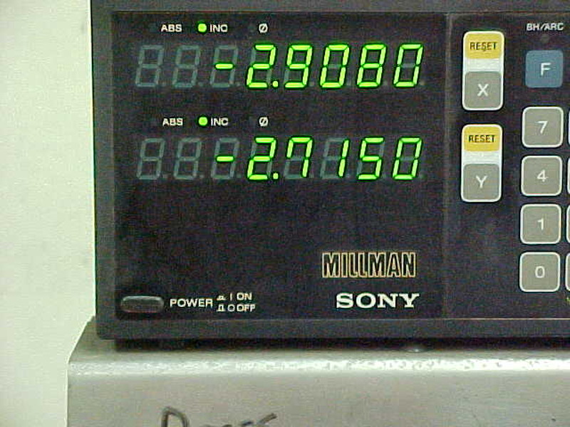

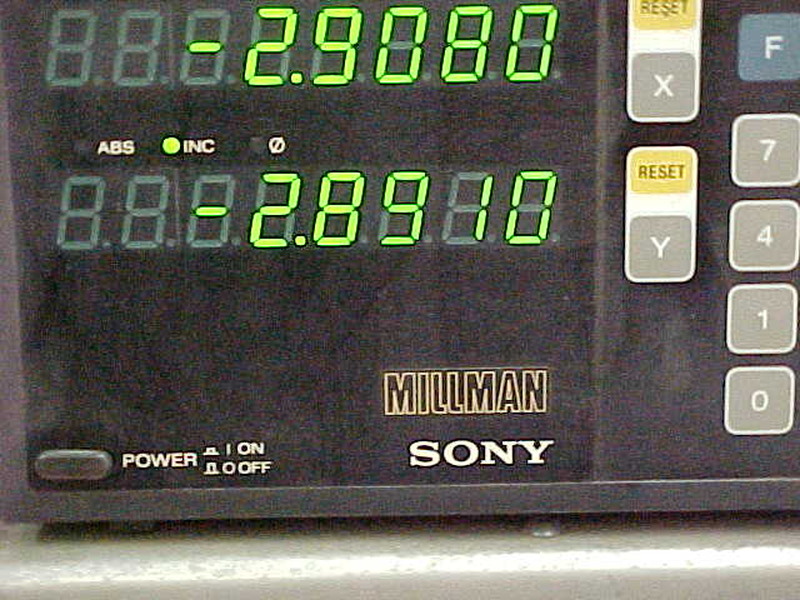

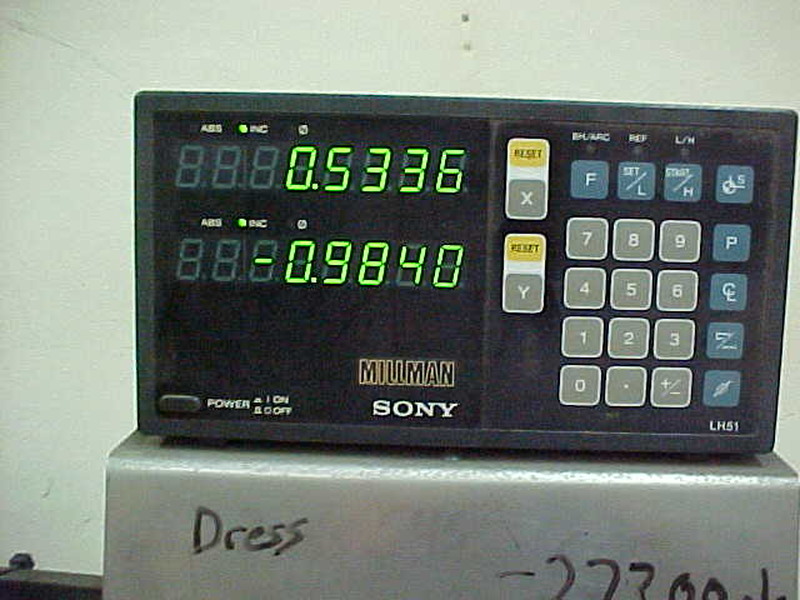

    Here is that number.

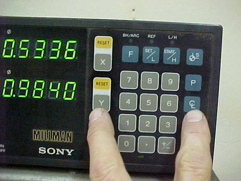

    On this readout I hit Y then CL (centerline)
    concretegrazer and 94BULLITT like this.
  4. Kevin in Ohio
    Kevin in Ohio
    Oct 15, 2014
    1,067
    6,287

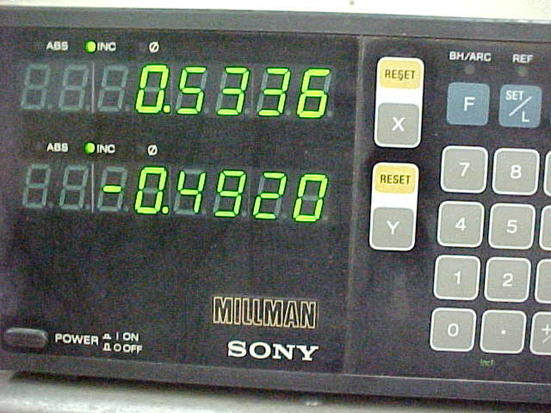

    This automatically splits it in have to where if I now dial to zero, I'm in the very center of the wheel. Handy feature for numerous things.
    Dialing into zero, I'm now in the center as you can see.
    My centerline is off .031 if you do the math from Stihl's set up so I move off that amount to dress the wheel.
    Swinging the dresser arm 180 degrees, I go down till it has dressed as much as it can. Then zero out the downfeed. You can see here it is off center now

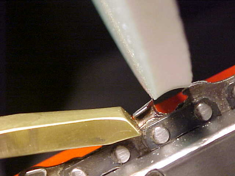

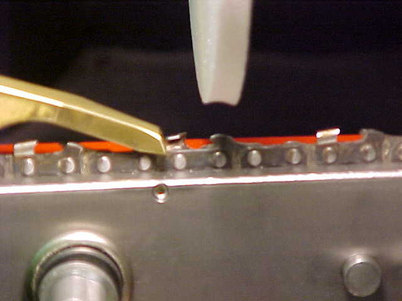

    Now i'll set the position of the wheel to the raker. I'll go the long way so you can see how the math works. First I dead wheel to the edge of the cutter.
    This is the number there. Now I have a reference to work from.
    Now if I add 094 to the previous number, that will put the centerline of the dress over the tip of the centerline of the cutter.
    Here you can see that it looks like they are in line.

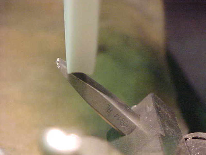

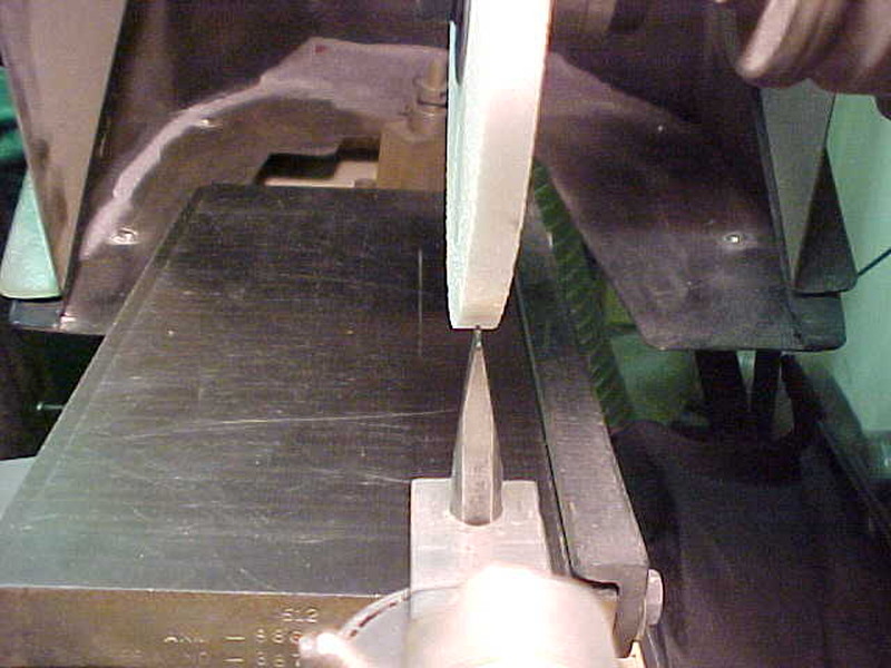

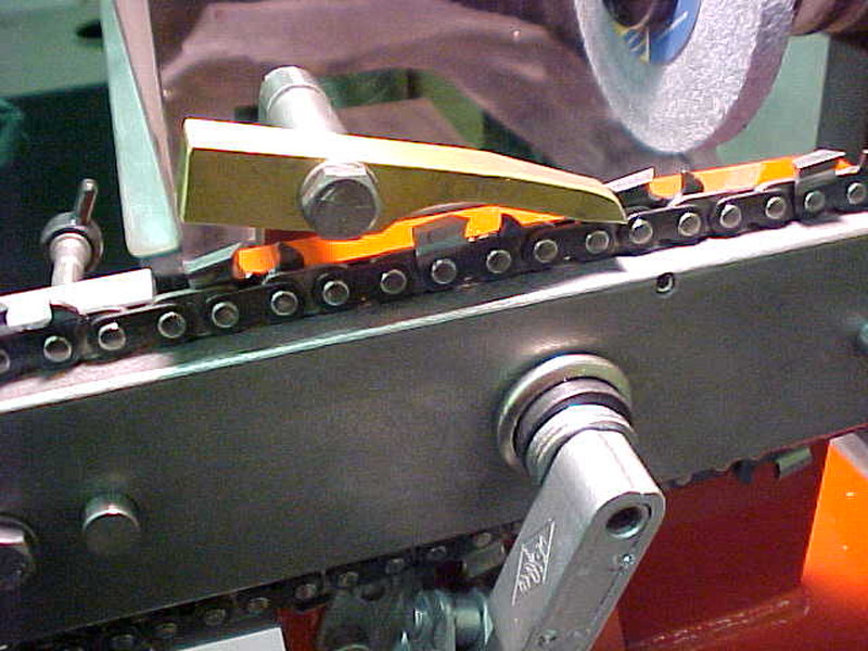

    Now I minus .270 from that number and this should put me where I need to be. I know you don't have to do these steps but I'm just showing the reasoning as to how/why you do it.
    With this done my infeed is set and looks correct. Now we are ready to grind. This process looks like it takes a lot of set up when in reality to very quick to do.

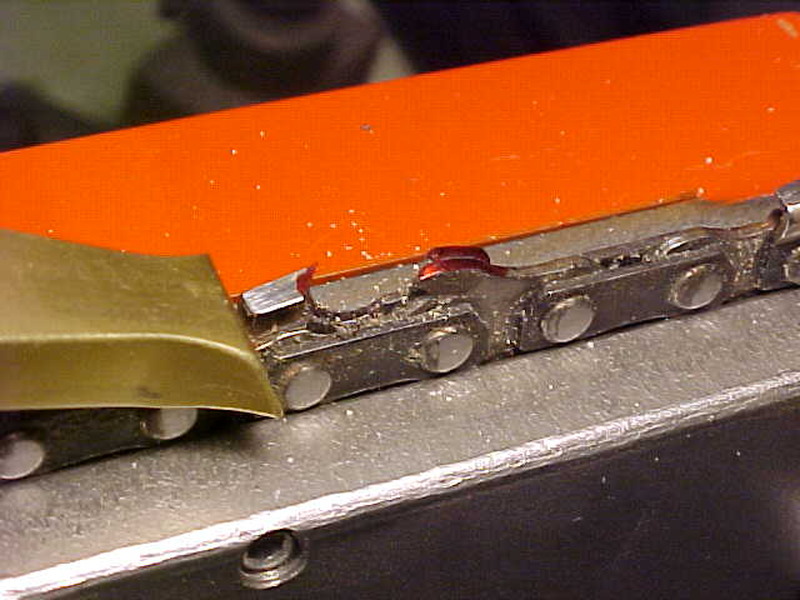

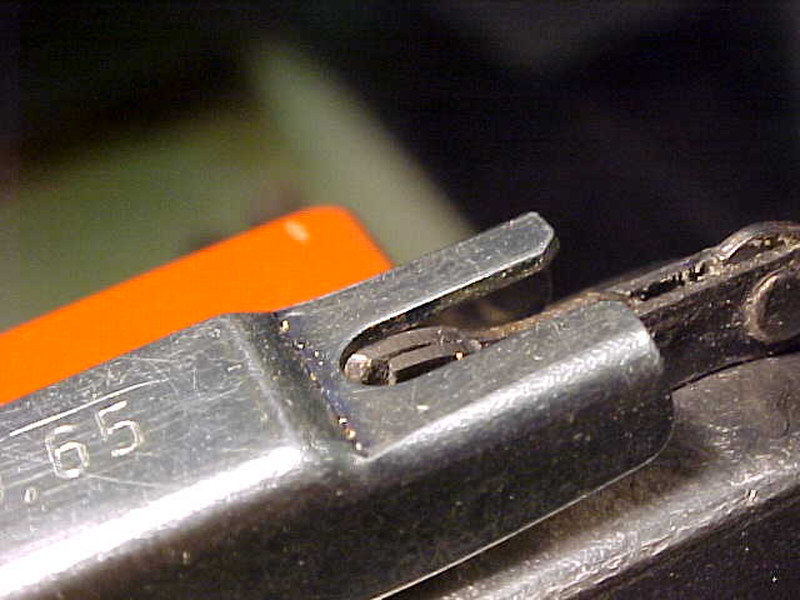

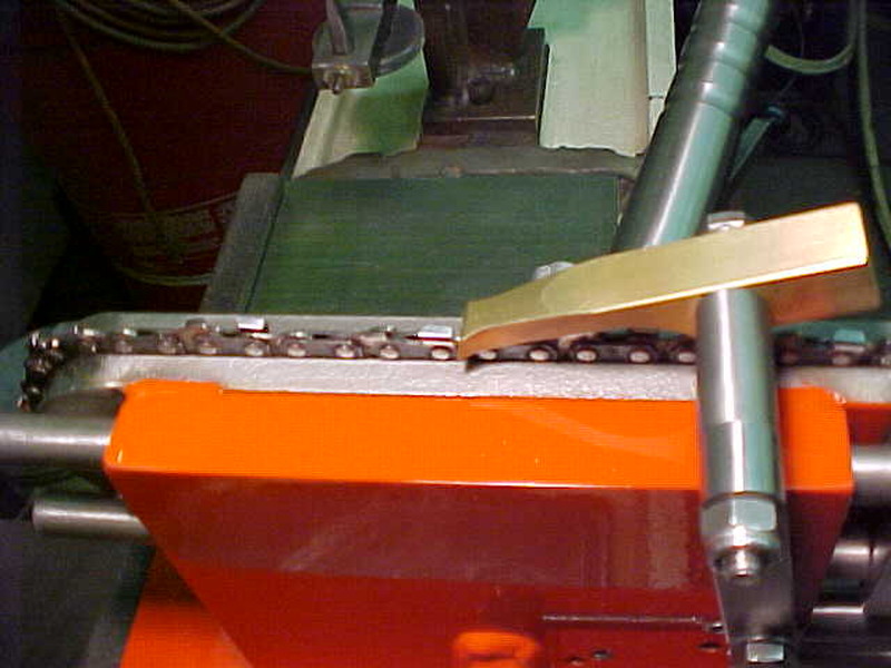

    This chain is a little over a 1/3 gone and rakers need adjusted. I ink it up prior to grinding to show removal.
    Reground to original spec.

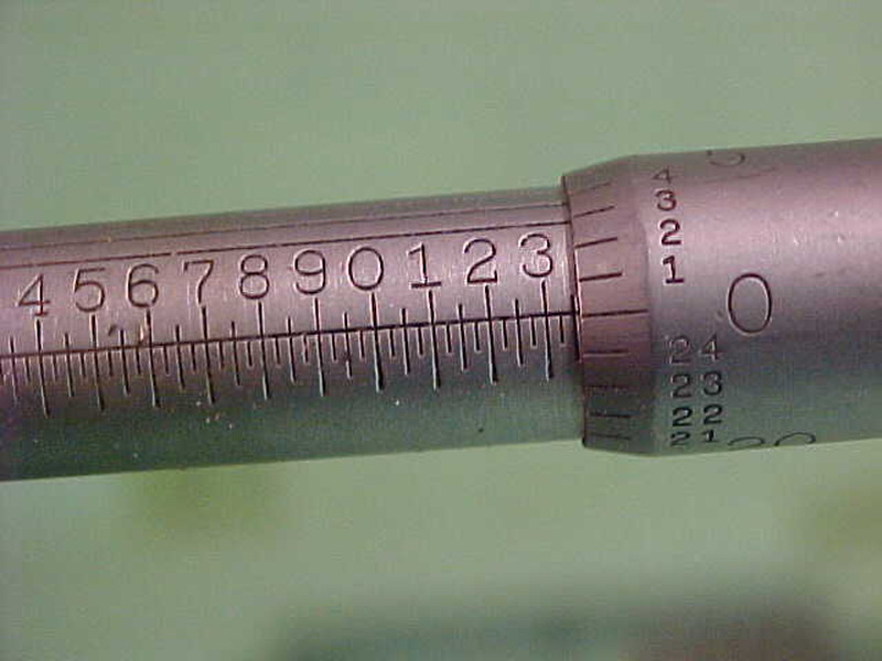

    I double check with a gauge and write my downfeed number down. I simply reindex, clamp dial up and back down to this number on every one.
    Here's checking it with a gauge. they all repeated very well.
    Someone asked about then weight. as it sits right here it is 23 pounds.

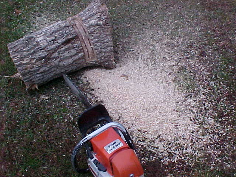

    Put the chain on the saw and ready to try it out.
    Using a 192 rear handle and happy to say the chain cut like a new one. No chatter and smooth cutting with very nice speed. Saw basically self feeds as it should.

    Nice consistant heavy chips with very little fines.
