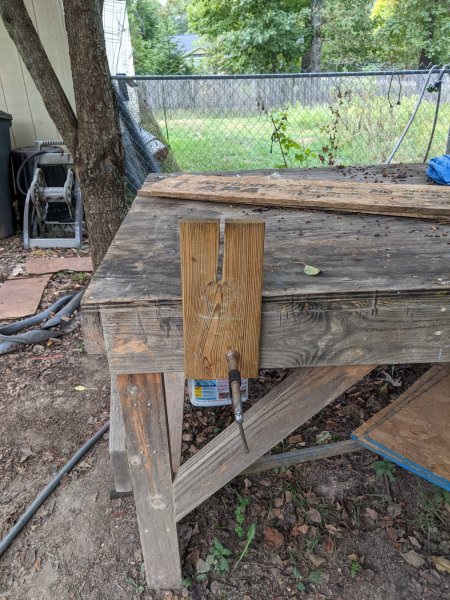

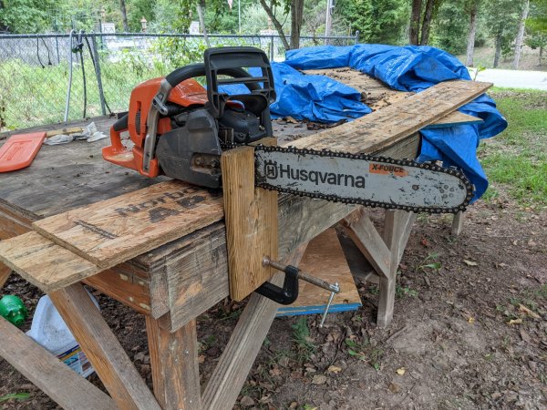

    Needed a quick and easy holder for sharpening at home. So here is what I came up with. Repurposed deck board and a C clamp. Work pretty well.
