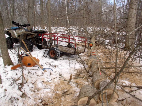

    Just make sure you consider the sort of weather you might be cutting in. Do you want to mess with paint?
    Perhaps this just goes back to the 50's when I worked in the woods. We used a 4' marker that was also notched at 2'. It worked great no matter what length of logs we wanted to cut. We also just used an axe to make the mark where to cut.
    I still sometimes use an axe, when it is wet and the crayon does not want to mark well. But that is rare.
    So now I use a 4' stick (any old stick will do but I like something flat so it will not roll on the log) and have it marked every 16". If we will be just skidding logs, we cut them at 8' so 2 measurements with a 4' stick works out fine.
    This is a really simple and easy method and nothing to clean up for sure afterwards. My wife can even use this! lol
    You can see the measuring stick on the log in the picture below. There are also a couple of log tongs, cant hook, pickeroon, saw, etc.

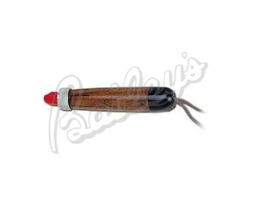

    I like a carpenters crayon but regular chalk will work just as well. I also put the crayon in a holder which keeps the crayon from breaking and is just nicer to handle.
  6. TurboDiesel
    16,244
    97,585
    I need one of those holders.
