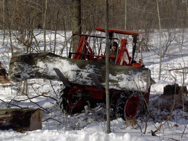

    You still may be surprised what you can do without ballast. Our neighbor uses his fel a lot with nothing on the back except for the loaded tires. I recall when I cut down a nice red oak near our barn and he took 3 logs (the tree was on his place) home with him from that tree. I don't remember the diameter of the tree but it was not exactly small. He did just fine with it.

    That's a nice size tractor and logs.
