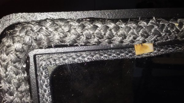

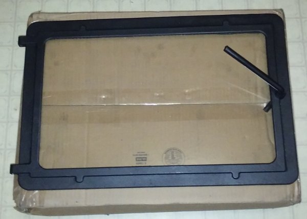

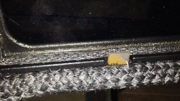

    OK, the wait is over. Considering the concern by MightyWhitey I made the effort to get some photos. Nothing to see really; it is just like the old one. I think ESW needs to rethink the glass retention system on the Madison but that is their call. I decided that a long metal bar with two tabs is what I would like to see here but I don't have the facilities to make such a thing and I am sure a metal shop would want more than a few dollars to fabricate them for me. Something more along the lines of the 30-NC. I will keep a watch during the burning season to see if the glass becomes loose on the new door; which is a great possibility considering nothing is different with this new door. I will pass along to ESW my thoughts; outlined above, on what happened. The last photo is the old door but there are photos in this thread of the old door as well.
