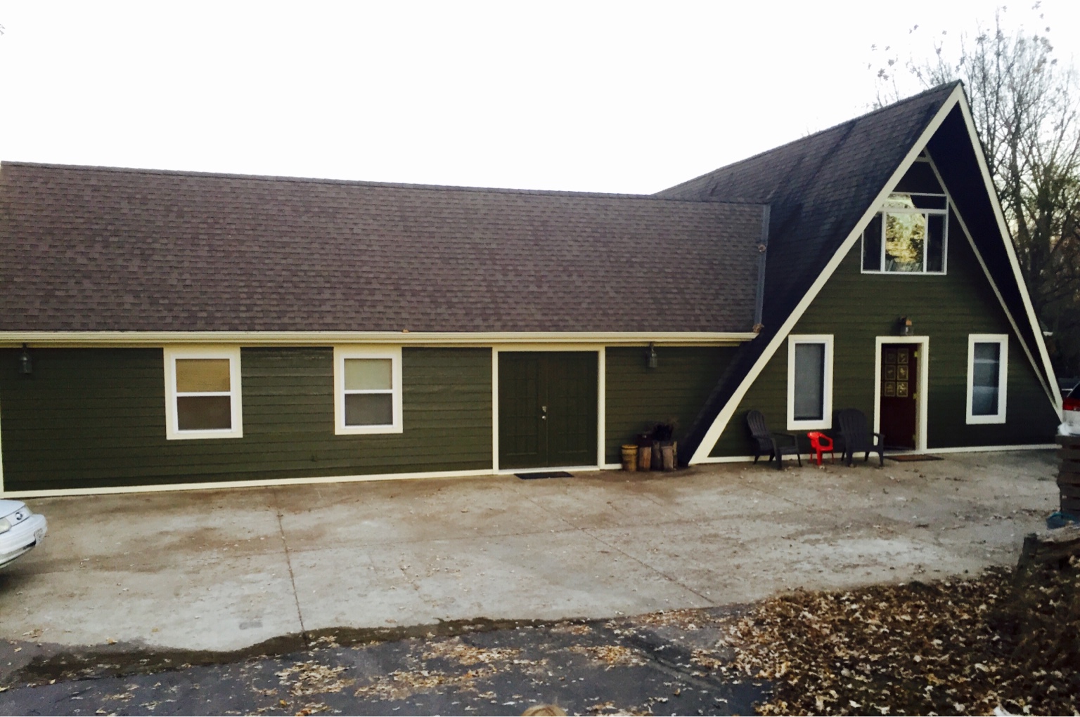

    [​IMG]Here is a picture of my Aframe

    A frame is kind of like a wooden teepee:D
