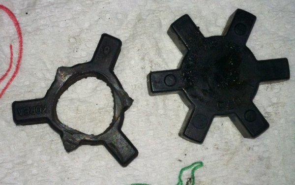

    I'm not sure on why you qouted me? From my experience the coupler failer that the OP showed is from misalignment. Lovejoy can say what they want. Some of the most pouros material made.

    There are only three spurs on a love joy, so only three of those spider fingers can wear out. The other three spider fingers are behind the coupler spurs. these would wear out if you could run the engine backwards...or forward and backwards...

    TurboDiesel the quote you referred to was talking about the nylon bushing between the lovejoys
    Here's a pic. New replacement is on right
    Screwloose and TurboDiesel like this.
  5. TurboDiesel
    16,238
    97,546
    yes,
    thats exactly how mine looked yesterday when i took it apart. three spurs were completely gone on one half of the coupler also.
    at one time the engine bolts came loose and it got really noisy. i didn't realize what was going on till i tried to start the engine and saw it move a little. i tightened the engine bolts and it quited back down. i suspect that's what damaged the coupler.

    kinda common on the cheap vertical shaft speeco splitters, we see half a dozen or more per year with the ears sheared off completely. they come with L075 series couplers, we swap them out for the larger L095 series as the 75 series is only rated for 3-4 hp depending on how you calculate the load and which brand of coupler your using.
