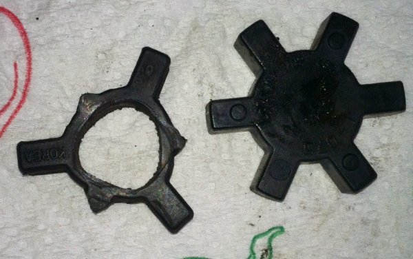

    To the OP. Love joy couplings require perfect alignment. IMO your machine has probably been tweeked from use. If alignment is not corrected it'll continue to have the same outcome.
    TurboDiesel, RCBS, HDRock and 2 others like this.

    WOW! I have broken the nylon before but never the teeth. Thats crazy.

    Well the spider didn't look so good either
    How could every other leg get worn off so perfectly?

    They can be used without perfect alignment, but the closer it is the longer things last...this one looks like it was way off...or something else is failing too. I've never seen fingers broke off like that either...I've seen them worn pretty good, not broke clean off though

    That is the whole purpose of the Lovejoy Coupler, a means to connect components without requiring the accuracy of a millwright to do so.
    I have seen a LoveJoy Coupler blow like that before. It was on an Extec Gravel Screen driving the tail conveyor. It just disintegrated all at once. The worst thing was it got loaded by the other components of the screen so I thought it was just overwhelmed, so I shoveled the whole thing off before realizing it was not overloaded, just not being driven. That sucked! I just ended up putting a new Lovejoy on it and it lasted another year at least until it was sold.

    ok all finished started engine and hydraulics worked
    Everything seems lined up close
    Problem was they did not sell any spiders with a 7/8 hole in center so
    I could cut the engine shaft or drill out the spider
    I drilled 3/4 and used a dremel with sander to slowly hog out the rest till it fit
    I don't know if it was my imagination but the splitter seemed to run quieter
    I checked out surplus center and they had the love joy fitting and they were the cheapest there, even including shipping! They look aftermarket but should hold up well.
    Thanks for the good advice everyone!

    Honestly no clue mine simply broke in half. It must have had just the right amount of tension on those areas of the spacer. I wonder if the motor or pump shaft is sleightly bent.

    Pallet Pete just one of those mysteries
    shafts were perfect just rusty before I cleaned them up
    everything works fine now!

    I disagree. Love joys are a shock absorber that do require perfect alignment. CV shafts are used when alignment or tweaking is a issues. Probably why manufactures have switched to belt drive IMO.

  18. mikeward
    mikeward
    603
    4,042
    Long Island, New York
    Horkn very interesting info. When I put the splitter back together. I first put the lovejoy and spider on the hydraulic pump. The engine is vertical shaft and was off. When I lowered the engine with lovejoy down into the spider it kind of self centered and was pretty tight. Then I put the engine bolts in and last tightened the engine shaft lovejoy.
    I guess time will tell how good a job I did. We'll see how long it lasts.have already split a couple of cords.
    Horkn and clemsonfor like this.

    I have never seen a spider with a hole in the middle (I'm familiar with and use Martin brand couplings)? Sounds as if the pump mount is "too close" to the engine? Or perhaps this is commonplace and I've just never encountered.

    RCBS that's the way speeco made the splitter. I heard they just make things out of whatever parts they can get and cob it together. Kind of like what jeep did in the 70's. buy a Ford carb modify it and slap it on.
    The local distributor called love joy to get one with whole but they only had 1/2" hole and I needed a 7/8" one.
    I got a solid one and had 3 choices
    cut 1/2 in shaft of hydraulic pump
    Cut 7/8 shaft of motor
    Drill out spider
    I drilled spider. Was afraid of heat from 41/2" grinder with cutoff wheel screwing up pump or engine
    If spider doesn't hold up next time I'll cut 7/8 engine shaft.
