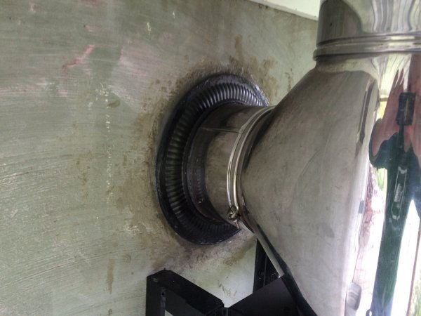

    Above is the support area. We used wedge bolts and tapcons here. There's a lot of weight resting on this area so it's beefy.
    Around the hole I packed Silicone and placed this trim collar for 8"ID pipe. This gives me a fairly clean look on the outside.

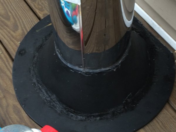

    Here's my solution for going through the deck. It's a FSP (finish support package) from my craigslist score. I primed and painted it, then installed a storm collar around it. Doing this maintains the 2" clearances and makes this water-tight under my deck.

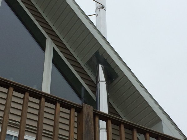

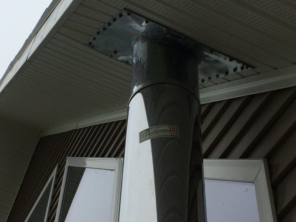

    Another challenge- when a pipe goes through a pitched roof, it isnt as simple as cutting a circle. So... My wife and I mocked up a template out of paper, then transferred that shape to flashing. We used adhesive and leftover tin screws to secure it to the soffitt.
  5. savemoney
    Beautiful install. I don't know what you will put in for a ceiling, but should you find the top of the flue heating up the ceiling more than you are comfortable with, you can take another section of chimney pipe and cut it in half length wise then mount it to the hot flue pipe with an off set of about 1'5 to 2 inches. This will go a long ways to deflect the heat from radiating to the ceiling.

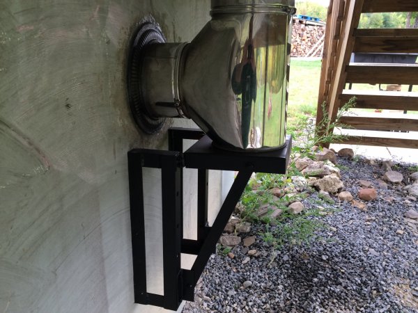

    Here's that second bracket system I made up. There's a lot of hardware up there but I wanted to be at or above code on everything.

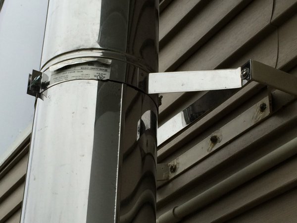

    Another custom bracket here. Props to DexterDay for his original basement install thread from a few years ago... I got my inspiration from him and others who've gone down this road before.
