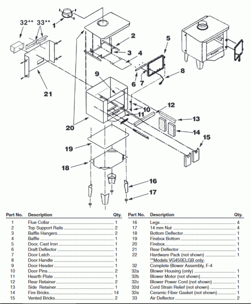

    Yes, scavenger , a wood stove should heat your house. To do that it has to be sized correctly for the area it has to heat. The curling baffle in your stove sounds like it has been run a little too hot. Have you ever seen the stove glow orange? The problem with running a stove too hot is that parts will warp and eventually crack. Once that happens the stove becomes dangerous...
    How big is the house? How well insulated? How well sealed?
    Once we have seen the damage to your stove and we know how hot you are running it we can offer some advice.
    I am going to guess it is part #4 that is warped?

    my house is 950 sq ft --better than well insulated --without a peep of draft that i detect and that is the piece that's curled down slightly when i look in and up--i've reached an amber glow but that radioactive orange eludes me to date--and hey walt did you decide to go?

    The amber glow indicates that the iron is at or above 1,000 degrees farenhite. That is too hot for the stove. Most manufacturers recommend that the stove should stay under 750F, some even less.
    The stove is rated for your size home, you should not have to push it so hard to keep the place comfortable. It is an "epa exempt" stove so it does not have the clean/long burning features of epa certified stoves.
    I know the season is about over but next season you should consider running the stove a little cooler. You should get longer burn time and the house should stay comfortable. If not there is probably something else wrong.
    If you get to one of the GTGs you might want to talk to the crew there about burning techniques. They might give you some good suggestions...
    Last thing you might want to consider is upgrading to an EPA certified stove such as the Englander NC-30...
