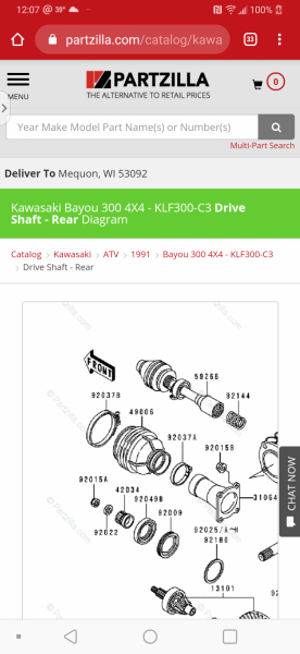

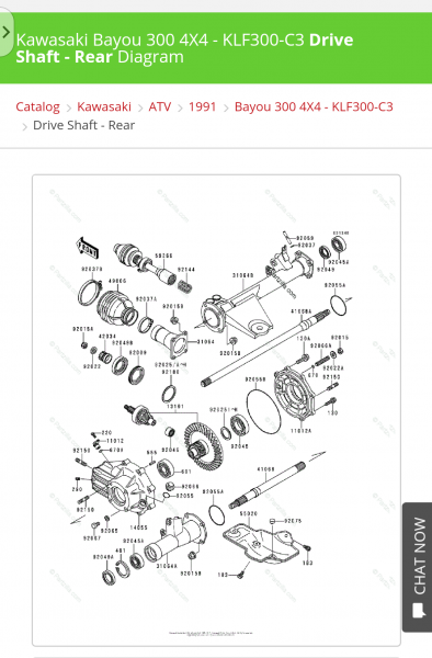

    One you get to my last part I might need to lean on you a little. Sounds like you know these machines pretty well. I've never had one apart to this level. It sounds like this seal that went on me has gone for others.
    Kawasaki ATV 1991 OEM Parts Diagram for Drive Shaft - Rear | Partzilla.com
    I think it's part 92049-1309
    The boot is 49006, $20.
    I'd assume that the rear axle needs to be pulled, and the rest can all be done?

    Screenshot_20200506-000752.png Screenshot_20200506-001557~2.png This... Screenshot_20200506-000752.png

    Looks to me like the axle can stay in place. Would imagine the nut and washer need to go.
    Just replaced the rear boot on my 2018 Polaris. Didn’t expect that to go so soon but I do drive it through some nasty vines and branches. You tube videos helped even though none of them were for my specific axle connection.
    Looks to me like your seal isn’t much different than today’s. Axles yes, they’re different. Seal looks pretty much the same. The tough job is prying it out. Think they make tools for that. Saw a little bit of that on YouTube just searching for boot replacement.
    Good luck.
    oh, check for slop in that axle in case it’s not just the seal that needs fixin.

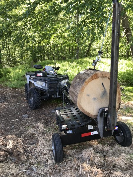

    I have a tractor and it sits now that I have the ATV. Mostly because my old tractor (MT) is such a pain to climb aboard and dismount.
    She pulls the wood and lifts it onto the splitter for me. All without breaking legs and shins getting on :)

    Very clever use of the atv winch! Had to blow the picture up to see everything you got going on there. Work smarter, not harder....I’d like to learn that lesson someday:hair:

    I had to learn that lesson real fast ;) Always worked like a Jack Assparagus until one day I exploded my spine with lasting effects.
    Only thing that changed on the ATV is those hard rubber wheels (bow rollers) were replaced with the hard yellow plastic ones. Rope cuts through the rubber pretty quick. Hard plastic work much better. My mind said it would be the opposite but nope, plastic it is.
    Eventually I will also get rid of the wireless Polaris winch controller. Wireless sounds great but this particular Polaris controller is JUNK!!
    Not sure if I’ll try another wireless unit or just a plug in controller.
    If I had to do it all over again I’d mount the battery and winch right to the splitter. Wasn’t easy getting all that electrical stuff to be compatible. And the dealer did it, not me LOL

    The rear axle needs to come off in order to replace the seal and the boot. Some of the books came out, some are being stubborn.

    I've never had the rear drive out of a Bayou, but that looks like a very similar setup to the Hondas of the same vintage...yes, axle needs to come out before drive unit can come off...not really that bad of a job...unless Kawi figured out how to overcomplicate something fairly simple...dunno, hope not!
    Edit: looks like they use a 2 piece rear axle...that's a new one on me...not sure if that helps, hurts, or neither.
