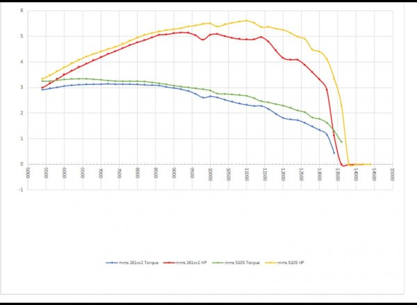

    Cutting speed increases are different than dyno power increases though. The two numbers might be close together but they might be quite aways apart in how they feel. It is easy to raise the exhaust way up and get 7 HP out of 346, but they don’t like cutting wood bigger than 4” without falling off the pipe either

    Here's a plot for a MasterMind261. A tick above 5hp. :dex:

    He discovered it quite a while ago because he and I were talking about it before he was even charging to do dyno runs. If a saw has 5HP and gains 50% in HP, it’s now 7.5 HP. If a ported saw gains 50% in cut speed, that is twice as fast as it was stock. So the numbers don’t directly correlate with each other

    Dyno info should still be useful though if you pay attention to the torque generated within the normal operating range of the saw. Outside of swapping sprockets, torque can only be manipulated by increasing cylinder pressure or using a larger piston. Stroking the crank or offsetting the piston/cylinder works too but that's not really within the realm of most "woods ported" saws. As long as you can keep the load under the peak amount of torque available, 7HP is 7HP. But that's the kicker isn't it? Torque matters more than HP because for any given size log, it requires a fixed amount of force (torque) to drag the chain through it. If there's more torque available in reserve, the engine accelerates until the torque curve falls off, equalizing with the load.
    Using the 7HP 346 as an example, if we were to gear it down (gear drive saw anyone?) so that the final torque output (match the chain speed?) was similar to a 90cc saw, we'd be cutting 36"+ wood no problem with that 7HP 45cc engine. It would just be heavy, and not last nearly as long as a stock 90cc saw exerting the same amount of force (torque) at a lower crankshaft RPM.

    One would have to dyno and cut in small wood and large wood with the same saw and recipe several times to get a feel for which one felt better and cut faster. The width of the curve makes a difference in the torque number as well. There is also something to do with the angle of the torque curve at maximum hp rpm. A saw can still cut well if the RPMs are dropping out of the hp curve if torque is still on the rise
