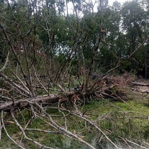

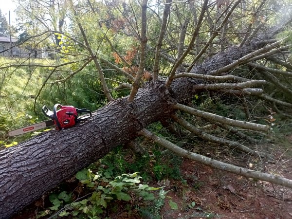

    I very rarely contradict or argue about this type of stuff but.....
    I would be interested in seeing you limb one of these with loppers.....to the tune of 50+ trees a day.
    And yes, 1.5 pounds of extra weight does make a difference when you do this kind of stuff for hours on end.
    And no, the extra power of a 50cc saw is not worth it, nor does it get the job done perceptibly faster.... in fact it can actually slow down your production.
    Yes, this is an extreme example of tons of small limbs, but it serves to illustrate the place a good 40cc saw has in the woods.
