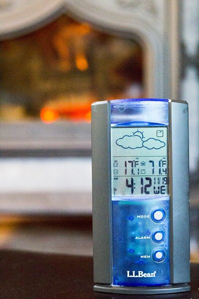

  13. Oldhippie
    Oldhippie
    Oct 14, 2013
    2,339
    6,733
    Ashby Ma
