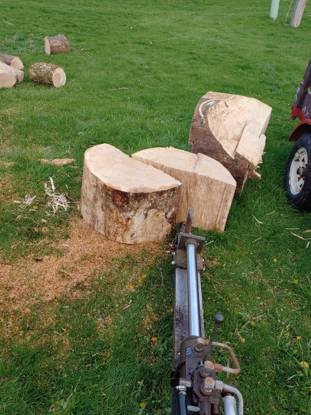

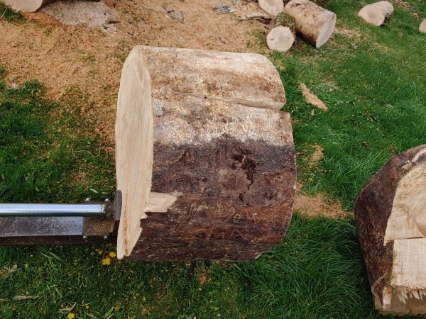

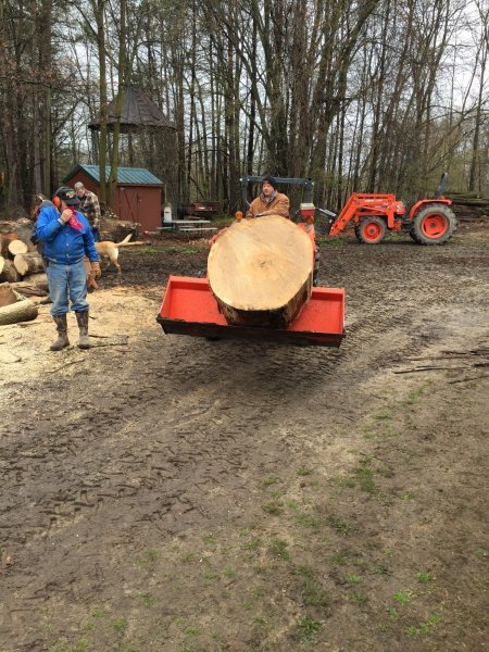

    That's what I do now. You can do it, it's just not as easy as it could be. :yes:

    Sure. You can do it if the splitter is laying on the ground. You can roll the rounds right up on the beam with that Dittier.

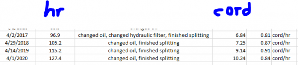

    I went from a 13 sec cycle time splitter to a 9 sec one and my splitting production increased damm near the same percentage. I do all my splitting of the winter's haul in early spring and I keep track of splitter run time as well as cords split, so it's easy to compute cord/hr. I split till the trailer is full and then I shut it off to stack...repeat.
    Here I am last spring using the new 9sec one splitting ~0.25 cord. From cold startup, warm-up and splitting.
    13 second cycle time splitter:
    New 9 second splitter:

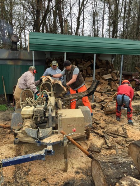

    TurboDiesel I see how that slowed him down BUT IMO that crotches should have never been put through 4 way! Single wedge so it doesn’t get wedged, Then a straight pice to finish split.

    It's still not easy though. Those halves suck to move even at half the weight. It's a lot of mind over matter, and use your legs to push the rounds into place. I use splits as steps or a ramp to get the wood into the beam. On a taller horizontal splitter, you better have a real ramp.
