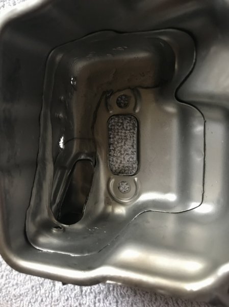

    No baffles, just an empty can needing to breathe.

    No baffle ? Hmm was one on my 261c when I split the muffler ... maybe you have a different version? 2B05AE9A-54A1-4BF0-91DD-68DB6C606146.jpeg

    A65C8B06-3A10-481E-AD5E-A00EAF1BBF46.jpeg The 241c and 261c have a baffle that can observed if you bother to split the muffler ... the 362c does not ;here’s a pic of the 362c ... ok kids ! Hawa Rice-Day !

    Are you referring to the screen retainer as a baffle?
