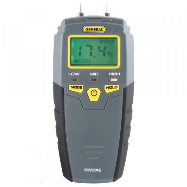

    They are cheap, 15 to 20 dollars. Mine has different scales for wood type; which I recommend as softer wood are different than the harder woods; so I have a setting for pine and a setting for oak etc.

    Eckie , regarding the moisture meter, do you have a smart phone with a head phone jack? If so, the Ryobi phoneworx moisture meter it's a great one for $20-25.

    I do, but i was pressed hard for Christmas ideas last week, so i sent this one as a dift idea, mainly cause it looked good on some reviews and i thought it could be found easy...
