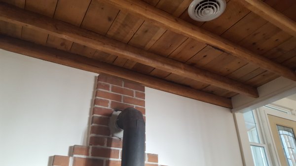

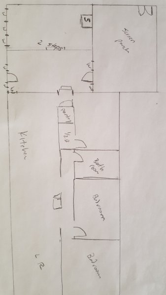

    Tried to draw a sketch of my house, showing stove location and air flow issues with rest of house. Forgive me, I'm no architect. Not necessarily to scale, but decent representation.
    Stove location marked by "S". Room with stove is a step down, 2 steps height (ceiling is also stepped). Also attached is a pic showing the ceiling of thenlower section, above the woodstove. Wood stove room may be a bit large comparatively in drawing, but is around 19.5 ft x 19.5 ft. Two more steps to get into "main" part of house.
    My issue is do i choose a stove that heats my approximate sq ft (1800ish) since it is a bit 'isolated' from the rest of the house. Would like to heat as much as i can with it, but have to be able to stand it in the stove room, since thats where tv is and we spend the most time. Can i overcome this layout with the fan at thenother end of the house trick?
    Next question...would the absolute steel run me out of this room? Also had T5 on my mind due to clearances and hearth pad requirements (ember). Like the reviews of the 30 NC, but that may run us out. Think a standard steel stove (which is what is in here now, Buck copy, yet to be used by me) may be too hot?

  19. Canadian border VT
    19,614
    130,431
    These stoves are very adjustable, I have the big brother the IS, I live about 15 miles from the Canadian border. A friend has the same stove and lives in Jersey. He keeps his STT
    Stove top temperature, around 300-350. On cold days I try to keep mine above 550. Easy to do
