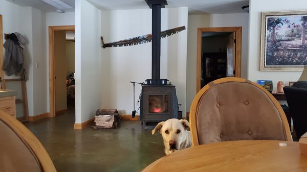

    the stove offers any and all of what you suggest, if I am running while in the house it is easy to go have throttle on half load to allow for a fire show WITH CAT ENGAGED.
    Like this morning in this picture I just took
    you can see the damper handle in back left... that is half throttle with 3 splits put in 2 hours prvious
