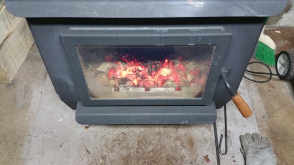

    On a blazeking stove if the glass is dirty and you have a hot fire in the stove will that clean up the glass some? For the blazeking owners out there how often do you clean the glass and the cat that is in the stove?

    I think the CAT maintenance really depends on the wood your burning and how much draft you need. I burn mostly white and red oak on low, that said i mainly just take the cover off to look maybe once a month, i only see a very little amount of fly ash on the cat after burning pine and cottonwood..... But while on the topic of maintenance, i take my stove pipe off between my chimney and the stove after every sweeping, there is always a bunch of junk laying against the cat after sweeping that cant be gotten any other way. I also make a point of two sweeps per year. The first of the season is right around new years when i have time, and again after we are done burning for the year. The super low chimney temps on the BK leads to a good bit of build up at the top of the stack. I had to take the screen off of my cap it was alost a monthly affair this year of going up and knocking the creosote off of the screen.
    As far as the glass a good hot fire does clean the class, most of it. There are still spots in the corners and along the sides that stay a little built up but its not a huge deal. I use a combo of a razor scraper and 0000 steel wool to take it off. I do this maybe once a month? More in the beginning and ending(shoulder) of the burning seasons. Here is a pic of my glass, the hazy areas are where it gets dirty. I've been burning down coals for about the last 8 hours though so the high heat right there has taken care of most of it.
