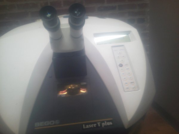

    I do understand what duty cycle is. Still trying to figure out what "A buzzbox losses duty cycle in its first rod" means though. Does it mean that if you stick weld with a transformer welder you're going to damage it? Does the duty cycle of a transformer welder continually get reduced as the machine is used giving it a finite amount of work it can do before there is nothing left?
    Couple crappy pics of the laser machine:

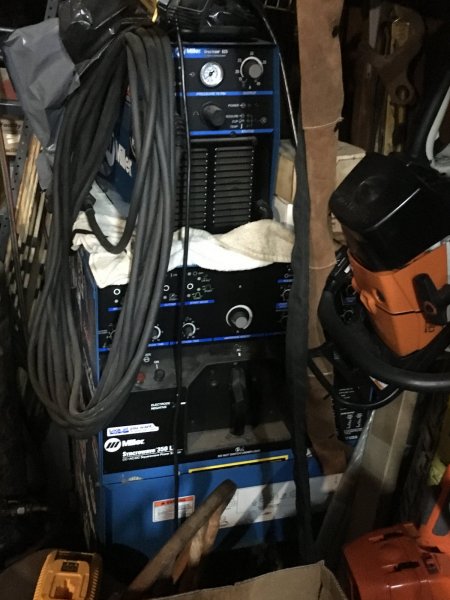

    That's a awesome welder ! I would love to see that in person. What do you usually weld ? Even my syncrowave is a transformer, but I wouldn't call it a buzz box. I think what he was saying was a transformer starts heating up on the first rod and keeps heating up. Once it's saturated with heat it trips a thermal cut out and you are left standing there regretting skimping on the size of machine you bought. It's all about heat dissipation. We put a Lincoln tombstone out in sub zero weather once with the cables run inside and carbon arced a cavity.

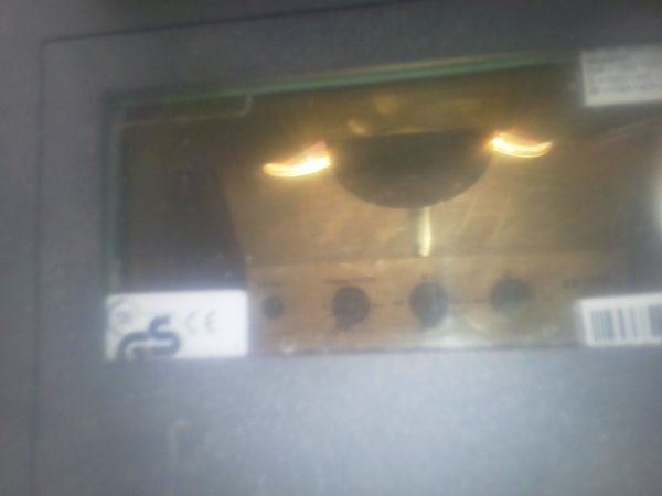

    We weld a few different alloys of mostly stainless and some precious and semi precious metals. I've only worked with the stainless alloys to date. That's mostly what we use in my department. Fill wire is mostly nickel. Use it for repairs on dental prosthetics. You can adj. diameter, intensity, and duration of the pulse. Hold the work with one hand, fill wire with the other, and trigger the pulse with a foot pedal. Scope has a reticle and depth of field is very narrow. When the work is in focus the pulse is on target with the crosshairs. Argon feeds in the box through an articulated nozzle. Pretty cool machine. I really enjoy running it.
