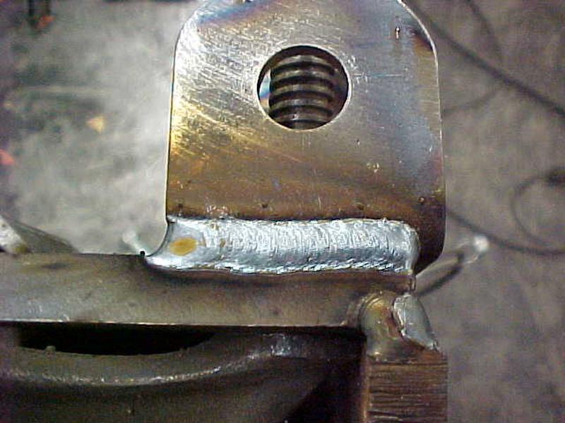

    I wish my mig welds looked consistently like Kevin's. Seems I'm always fighting cold starts, especially on aluminum.

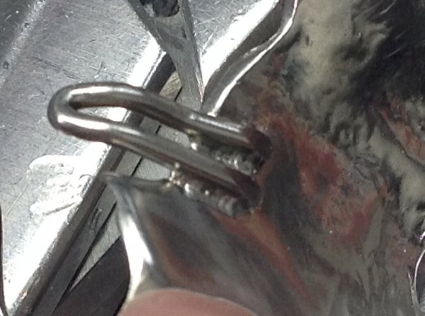

    Would you mind explaining this to the uninitiated in the room? What is a "buzzbox" and when it looses duty cycle doe that mean if the machine has a 50% duty cycle the minute you use it it'll essentially be damaged and have a 30% or 40% duty cycle? Or does it just drop as the machine warms up and then recover when given time off?
    Then as far as the spool gun on TIG goes, what is the difference between running a spool gun on a MIG and a TIG where the function of the machine goes?
    And since this is turning in to that sort of party, anyone else do any laser welding? I've been running a Bego Laser T Plus at work. The "rod" I use is .35mm and everything is done looking through a magnifying scope.

    This is about as good a pic as I can get:
    That's .045 wire welded to cast.
    Screwloose and brenndatomu like this.
