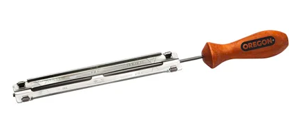

    Is the Oregon Sure Sharp a decent tool? I’m trying to figure out what to get and I figured everyone on here is more reliable then YouTube. Looking at $150 or less if that helps with recommendations. I currently just use Oregon round file with guide and wood handle. I would rate my ability as fair to horse crap.

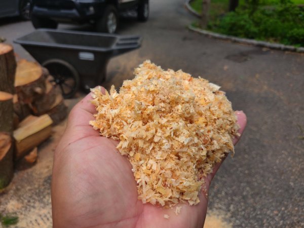

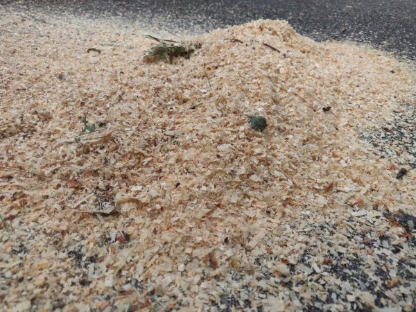

  18. LordOfTheFlies
    LordOfTheFlies
    Apr 5, 2019
    2,519
    12,091
    NY
    Filed free hand. I'd say the chips are looking pretty good. Saw cuts like butter. This was from a mix of spruce, pine, and black locust.

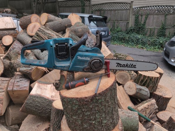

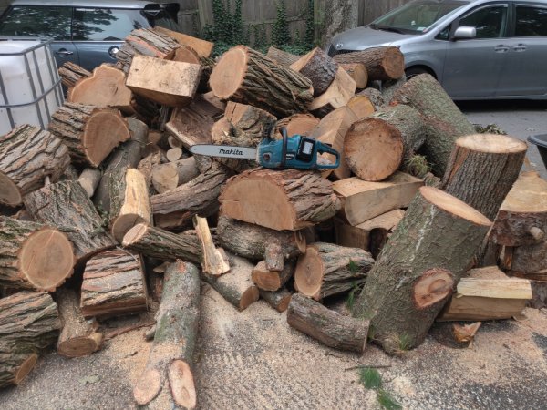

  19. LordOfTheFlies
    LordOfTheFlies
    Apr 5, 2019
    2,519
    12,091
    NY
    I put the whole chainsaw onto the vise. I don't take the chain off the bar.
    The little extra wedge there was because everything was cockeyed and on the sloped part of the driveway. Now I do it on the flat parking spot and try to find a level round.
