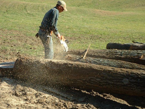

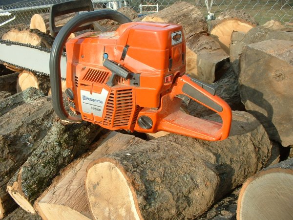

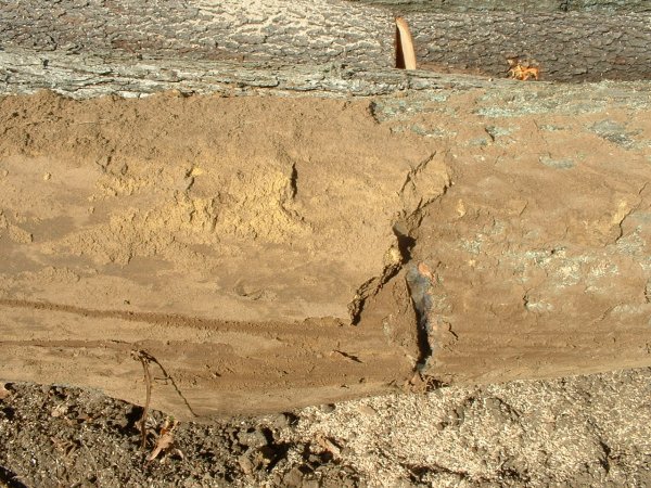

    Fair statement. The biggest thing I find is one needs to adapt to whatever the situation they are dealing with. For many years I have used nothing but round ground chisel, Oregon LGX and buy it by 100' rolls. Lately the cabled skidded log cut offs have had such unreal amounts of dirt the only solution was to switch to 404 semi chisel and use a hard nosed bar on a 395XP. Rather than cutting from the top, a log is plunge cut almost all the way through, cut down and out the bottom, then push the bar the rest of the way through and cut up throwing the dirt away from the powerhead. This will extend the life of the sharpening by 3 times. DSCF0010.JPG DSCF0015.JPG DSCF0008.JPG

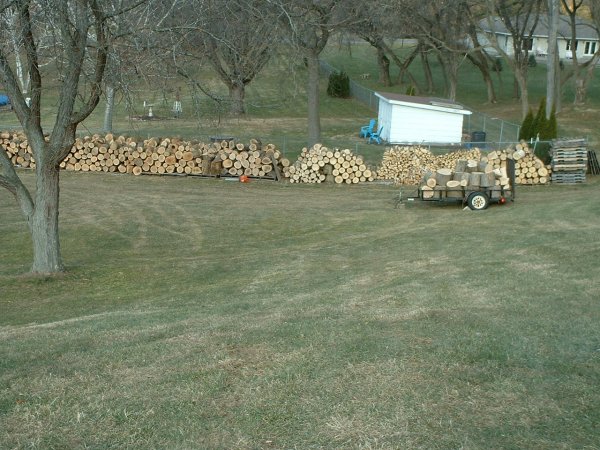

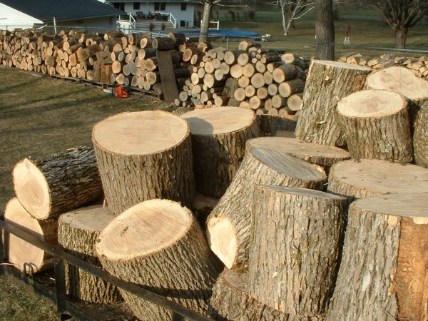

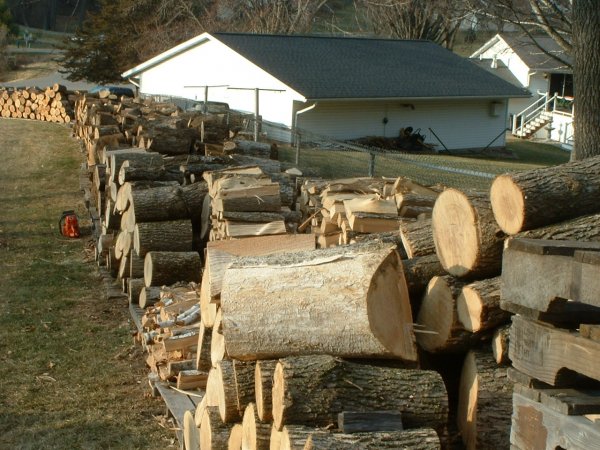

    Biggest thing for making a saw cut fast is a SHARP chain.
    This is what I cut in the last 6 weeks or so.

    That is a lot of dirt in the bark. Yikes.

    It's just the price of admission. Cutting large log cut offs generates a LOT of firewood in a hurry. With 404 semi chisel and plunge cutting the rounds I can get a tank on the 395XP cut and that is a LOT of wood. With 3/8ths chisel I couldn't get more than 1/3 of a tank without touching up the chain.
