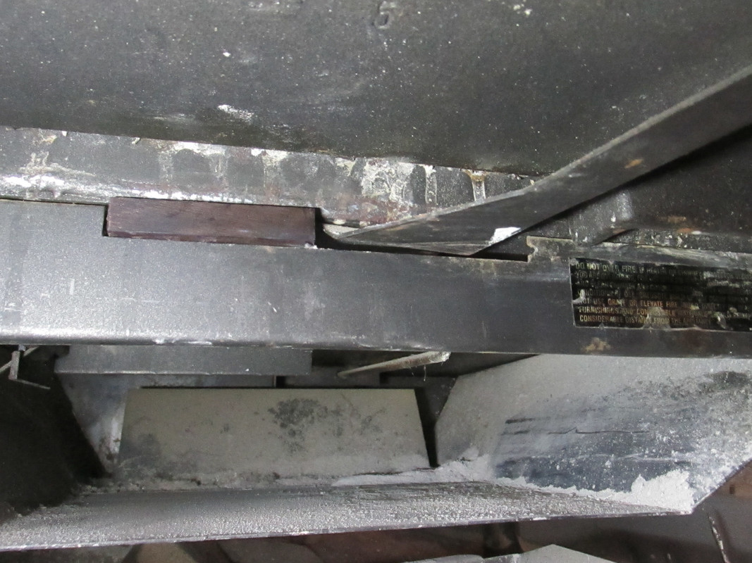

    So I assume that the lever works: full left 100%, full right 0%...how about doing what you propose there, but move it to the right of the lever, drill a hole in the lever, make whatever you attach to the stove so that a lock can be attached to it and the lever...could even slot it for a minimal adjustment as needed.
    Or just put up the baby gate/fence with a lock on it...
  2. The Wood Wolverine
    18,843
    121,267
    Small hole in the lever and the wire could be used to lock it in place, or as mentioned it could be restricted from being full opened.

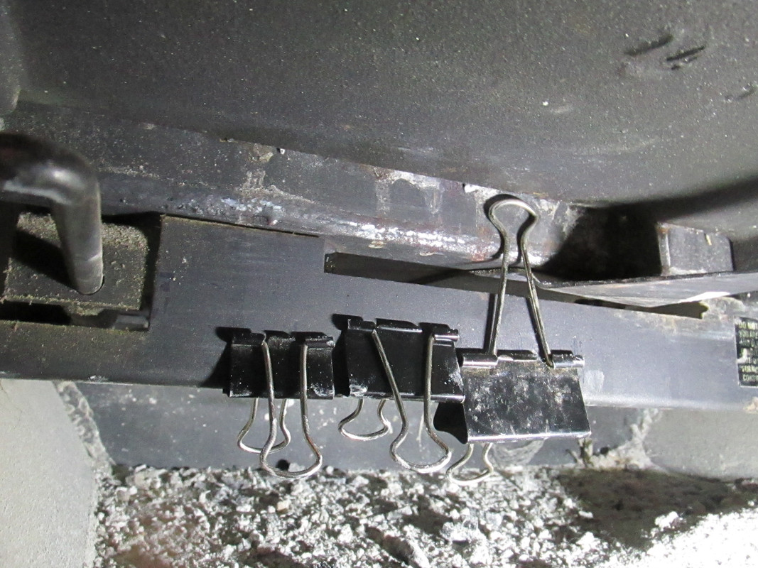

    These binder clips are very strong surprisingly and easily removable if need be.:coffee:
    Doesnt bother the ash pan at all.:cheers:

    I'd end up in the stove ww with that railing.:hair: :coldone: And just dropped the one on the right a tad as it was getting the squeeze part pretty warm.;)
    No Dew came from Mom and SIL is my pink eye buddy.:D

    Could you install a small C clamp on the backside where your fingertips are? Easy to remove if you need to.
  10. Loon
    Loon
    6,560
    37,138
    North of the border
    There is a little lip there but not enough to get ahold of. Added another clip and i know she wont reaf on it as she feels the resistance on her stat at her house. Full right! :hair: :coldone:

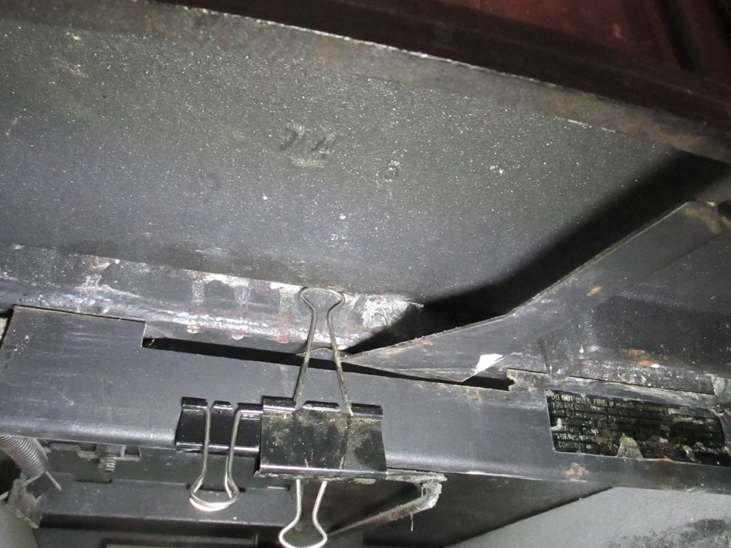

    Ok new problem..The clip now comes forward when you slide it hard to the left. Dremel will be out tomorrow for a little groove to catch it on the slider.;) :cheers:

    So yours slides laterally and is not a push/pull damper. Why not just put a wedge in the gap.

    You know...if a feller was to cut and bend a piece of flat stock the right way to slide into that slot to block the lever...maybe bend it so that it can't easily be pulled straight out...kinda hooks onto that bottom lip or something...
    Edit: Looks like XXL beat me to it...

    Thinking in my little mind this will be better man.:yes:

    Cut off some square dowling and some high heat paint and done. :cheers:
