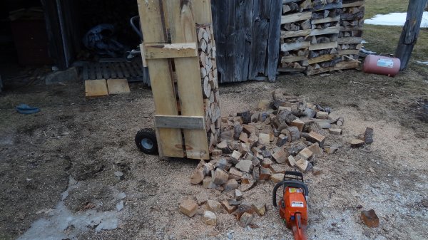

    I'm posting to an old thread because it was one of these older threads that gave me the idea for today's entertainment...
    Mounted to a dolly so I can go into the woodshed and fill it up, come outside and make a mess, and then roll back inside to stack it. The original idea was to go inside and dump it after cutting, but there is a lot of sawdust in between the splits after cutting, so I handled each one as I unloaded - thunked them together and tossed them into a pile. Doing this exercise because the Absolute is shorter than the PH.

    Works good doesn't it?
    Cool idea hooking it on to the dolly.:thumbs:
    I hear you about the sawdust, I don't want all that extra sawdust in the stacks.
    The little pieces too, because I catch them in a bin below there is a lot of sawdust in there, so, I throw them on a expanded metal ramp that I have, to knock all the sawdust off before I put them in the crates for storage.
    With those chunks you can build just the right size fire you need for shoulder season days

    It works much slicker than I expected. The weight of the splits locks them in place, so the little splits don't jounce around when the chain gets to them. So much safer than putting a foot onto each piece and cutting beside it.
