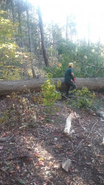

    Another tip, while I mark my logs where they fell, if I am twitching them tree length, I do not buck them up there, instead I just "ring" them. I take my saw and make a shallow cut as far around the tree as I can. This way as I come out of the woods and into my landing, I can stop at my pulpwood or firewood pile and cut off the top where it was last "ringed", then move forward to my log pile with the log portion of my tree. Once pushed up I can then buck my logs up having already been measured in the woods. Ringed like they are, it is easy to see where the marks are.
    You can see a photo of me marking out a Hard Maple log here. If you look close, about a third of the way from the edge of the picture you can see where I "ringed" the log to mark off the butt cut veneer log. The cut is very shallow, and while it does not look like it in the photo, had it been bucked fully, the two ends would have been sitting on the ground.
