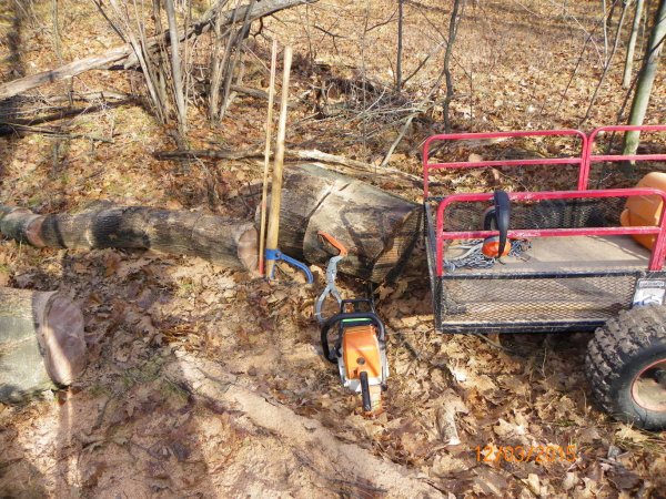

    We want all 16" wood. Our low-tech answer is a 4' stick marked off in 16" increments. Why 4'? Because sometimes I want to cut 4' lengths to haul out of the woods using FEL on tractor and any wider I can't get through many spots. Also, 4' is a handy length to carry around. Stick breaks? Just grab another one or use a branch.

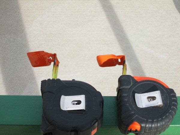

    Hey Jo191145 which is a great choice in pistols by the way, I like your idea of welding a bigger tab onto the tape. I go to the mountains and cut wood and I always use a cheap tape measure and now you just gave me a way to improve that. Thanks.

    Ok Jo191145 here are the two I did. A small piece of sheet metal and tig weld. One for the mountains and one for the wood processing area at home.

    Looks good. Let me know how it works out.
    Been debating in my mind wether some small spikes/points would help. Probably not needed and cause more blood loss than benefit.
    Without spikes it can fit into a chainsaw kerf if the need arises.
    I only have a stick welder. Not the best method. Good to know it worked with tig. Thanks.

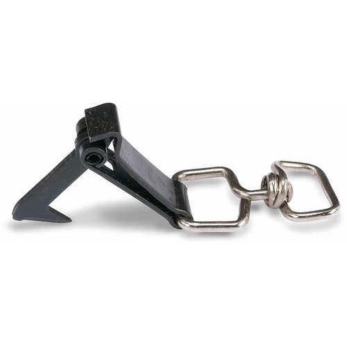

    My tape has this for a tip. It pokes into the wood so it stayes and releases when you tug on the tape. AND you can clean your bar groove out with it! :cool:

    Those two tapes that I welded on were free from harbor freight with a coupon I had. I probably have 4 or 5 of them around here. I am cheap.
