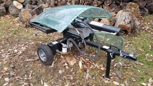

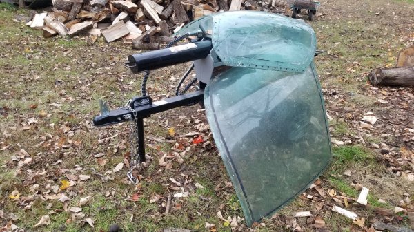

    I store my DHT 22 ton splitter under these old airplane windshields.
    Once the snow flies I used to shove my predator 20 ton into the church basement, I don't know if this one will fit through the basement door.

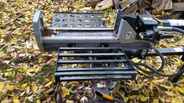

    Picked this up on EBay for $829 and free delivery, the county line table was the only modification I've done to it so far.
    I added it to give me more options for splits, but I actually like is better than the DHT table.
    I also added it to protect the filter casting from dropped rounds.

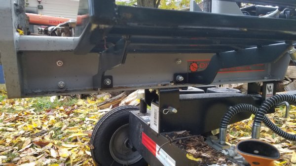

    My next modification will be a slot or holes in the plate at the ram cradle end of the beam. It collects dirt and trash and eventually packs itself full

    Did that other table Bolt right up or Did you drill holes ?

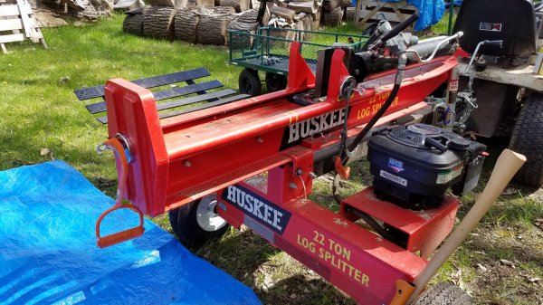

    My Huskee Has holes at the end of the beam, Strange that doesn't have them

    I used one original hole, and drilled a hole in the beam for the other end. It was actually easy to drill as the beam seems to be mild steel.
    There are holes on the base plate end, the trunions and retainer plate for the ram create a box that catches any junk the wedge drags back on the return stroke.

    That County line Catcher Looks better than the one on mine I could make it fit , Drill new holes or whatever .
    I wouldn't want a table on the operator side though I don't think It would work well for My size .
    Oh, Wait a minute :smoke:, It might workout if I cut part of The one I have off and make it smaller For the operator side
