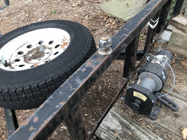

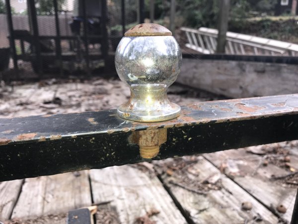

    I set up my medium trailer with a ball drilled into front angle iron. Now I just attach splitter there, block and strap wheels down.
