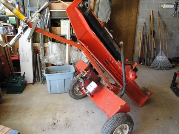

    The Speeco I have has the filter on the input side of the pump. It has worked without any problems for over 25 years. Speeco 25ton splitter-1.JPG Hope I didn't jinx myself:whistle:

  3. brenndatomu
    25,378
    165,428
    They did that on some older ones... didn't take em too long to figure out that was a bad idea...you must take decent care of your equipment though, or at least not operate at extremes that would make that "weakest link" fail...

  4. Erik B
    Erik B
    May 12, 2015
    5,713
    39,574
    Western Wisconsin
    I do keep it inside when not in use. I am only using 3-4 cords per year and I don't run it more than 4-5 hours per day when I am doing my splitting.
