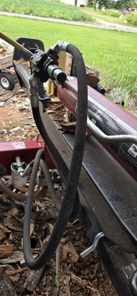

    I can't remember the correct name (brain cramp), but that's where you adjust the detente kick-off pressure so the control handle kicks off at the end of the return stroke. There should just be regular o-rings in that end, I think, not hard to find.

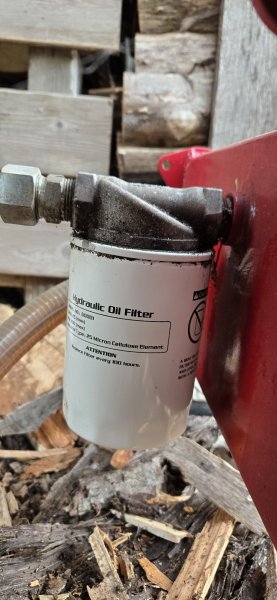

    That happened to me a year or two ago. You might remember the thread on it. Ended up getting a new pump and filter housing.
    The filter on my bobcat is a CP75210
    The filter on my splitter is a napa 1551
    I believe they are the same filter.

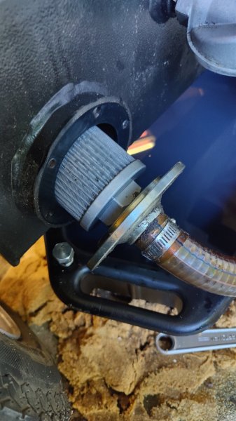

    I had thought it was the return line on mine leaking, turns out it's that flange gasket. I think I may make one out of veggie fiber to replace. I assume manufacturer thinks we are using unfiltered old fry oil considering the extra screen and micron requirements? I guess over filtered is better than under.

    The filters are primarily intended to catch debris that is sucked in through the breather. Small hole breathers “inhale” more dirt, dust, and debris than you think. That little hole is meant to keep bugs and debris out, but it makes the air move really fast through it. That acts like a vacuum cleaner and sucks in anything near it that isn’t glued down by oil residue.
    I use a large breather cap on mine that looks like a mushroom top. It keeps rain out as well as blowing snow. The only thing that might get in is very fine dust, but it would have to go through the oiled metal wool first.
    You also have a chance of seal material, hose chunks, metal particles, and pieces of sealer circulating in the oil. I had my filter bypass break and make it through the tank and back into the pump. Yeah that pizzed me off. The casting for the bypass was incredibly cheap and really bad quality. I replaced the pump and put a pipe plug in place of the bypass. I drilled a calibrated hole in the plug to act like a self regulating bypass. It has the ability to flow the full pump volume at higher pressure, but most of the fluid goes through the filter at about 1-2 psi when the fluid is warm so hardly any goes through the hole. This ensures a very high filter rate while eliminating the possible failure of the bypass. If some particle does get in the oil, there is a 95+% chance it will be caught in the filter. If it doesn’t get caught in the filter the first time, it will the second time.

    7-8 years of use. Clean as a whistle. Once I get a decent gasket on there I will never be removing the flange again. Taking old filter to NAPA to get a match today or tomorrow.

    Those who have larger capacity pumps, check the max flow rate of your filters. I have a 25 GPM pump on mine and when I went to buy a replacement filter they all had stamped on them the max flow rates, which were NOWHERE near the flow rate of the pump (IIRC, something like 8 or 10 GPM). Pretty sure the OEM filter was the same way too. So the filter would end up being in partial bypass pretty much the whole time the engine is running at high idle/full throttle under a load.
    I ended up replacing the filter head and filter to match the flow of the pump.

    Got one of my broken flange bolts out last night. The other will have to be drilled. Hoping to knock it out this weekend. Only waiting for that and to make a new flange gasket to get it all back together and running on Dex3 fluid. Going to see what hose I have at work to replace the suction line to pump. The hose on it has stiffened but not leaked. I don't plan on any more fluid purges any time soon, so looking to refresh it for service life.
